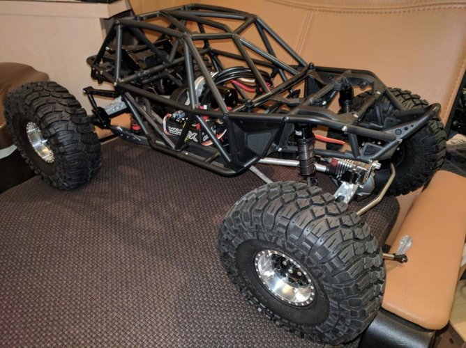

Revolver installed - early build process pic (the silver metal plate on top of the cut-down shift servo mount is my ESC mounting plate) - the section of the can with the lettering and the cap on the end of the motor with the "bullet chambers" - that is the part that rotates when you feed 'er some go-juice:
