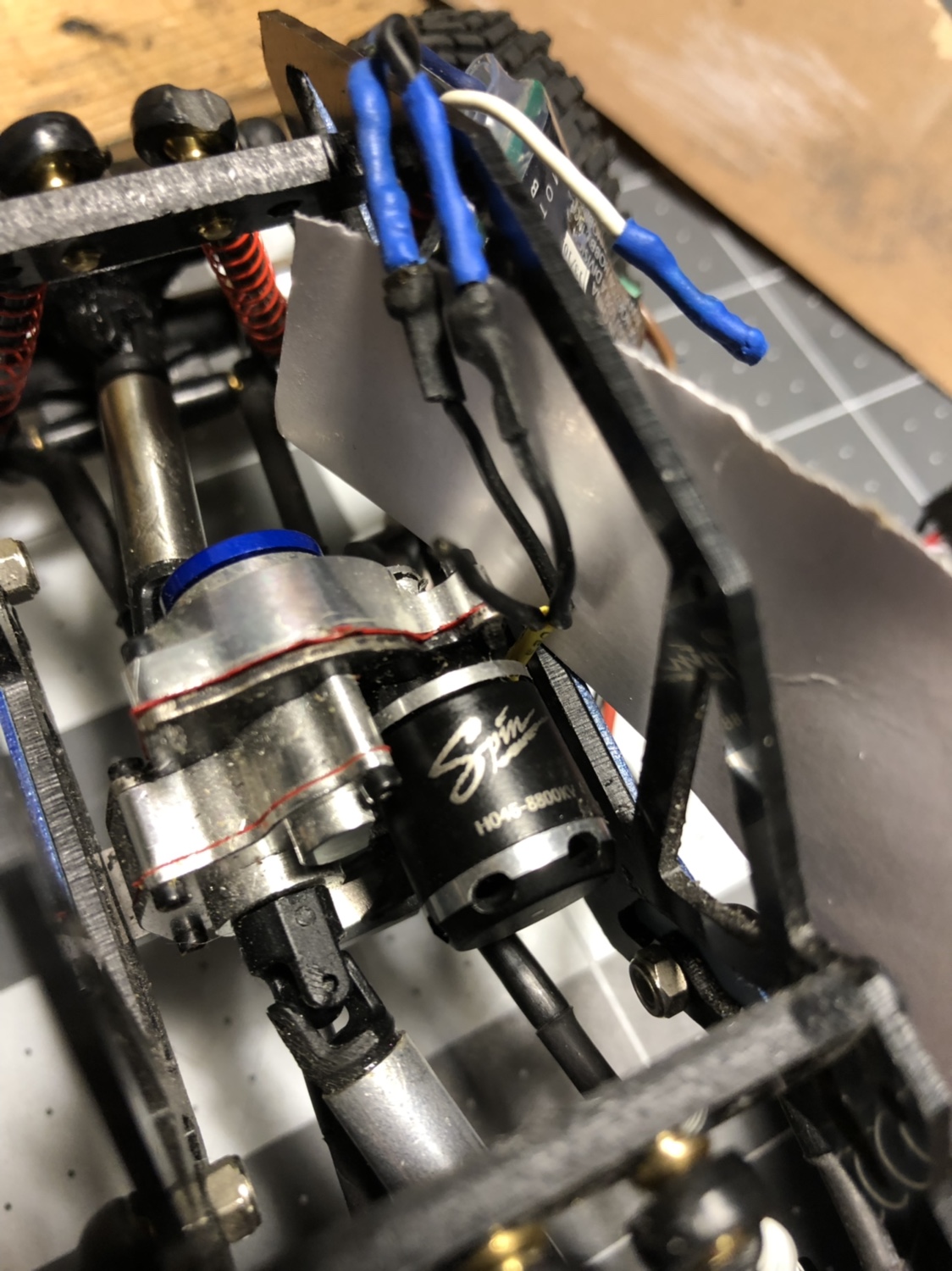

Spent some time in the garage last night. Pulled the shocks off the black trekker and the RX out of the dingo and plugged everything in on the comp rig. so I could find out what is what. It moves! It wasn't moving like it should tho. Very jerky and weird. Figured ESC probably needs calibration. When I went to do that I found one of the motor wires had come lose. The motor is a cool tiny revolver type motor. Didn't know that till I put power to it. I will try to rewire it next time I get some time. Almost looks like it's one wire that comes out of the motor then splits into 3 going to the ESC. The motor is a Spin HO46-8800kvAnyone have any experience with this motor? Also have to pull the servo off the trekker and put it on this rig. Which is fine with me it's a better one anyway. The one that's on it doesn't work at all. Here's a few pics
I haven't messed with brushless motors in some time but pretty sure that's why it was jerky, calibration may have a little to do with it but pretty sure if you connect that wire back up it'll be much smoother.

Well this little guy is still fighting me. Pulled the electronics out of it. Found another wire that the solder joint came loose. Resoldered it and got the motor to work. Put it back in the rig powered everything up and 2nd pull of the trigger the plastic pinion gear came off the motor shaft :x . Kinda aggravating, but that's life. Did some research on this little motor and after translating the web page. I found that it's a helicopter/drone motor and doesn't like much of a load. Hoping I can make it work out, but idk. Might have to look into other brushless micro motors or go brushed. I think I'm gonna put these little guys on the back burner for a few till I can gather up a few things for them. I don't like stuff to sit so I'm sure it won't be long till these guys are back on the bench.

The spur gear is a HR 56T. I'm thinking a 15t pinion should be about the right tooth count? The motor that's in it is a spin HO46-8800Kv with a 1.5mm shaft. Other option is to get a different bl motor, but don't know if that would make any difference. Here is the ESC that's in it

I'd get a 9t or 10t pinion. 14t is way to big IMO

That's what I have been hunting for since you gaveme advice in the other thread. I found this one https://www.megasmicros.com/product_p/pinion-1p5b-10t-0p3m.htm and also found https://www.aliexpress.com/item/-/32610226085.html the second one is a lot with 8t,9t,10t,11t. Since this is a crawler and I'm trying to gear it low I'll probably just buy the single 10t for now and see how it works out. I put the one out of my servo on it, but couldn't get the gear close enough to the spur before the motor hit the trany case. Hoping these ones will be a little bigger. The description doesn't say the width of the gear.
If it doesn't reach try slotting the motor plate holes

Being a outrunner the motor can't touch. Notched the motor slots and found out that motor touched the trany case before gear was close enough.
