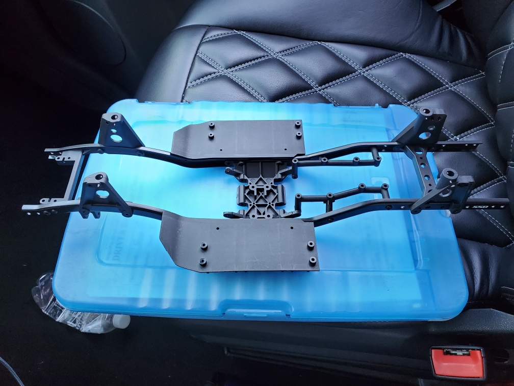

Today, while my clients were enjoying their lunch, I decided to start on my Trail King Pro (I also had the Trail Finder 2 kit, as well as my "Imperial" Capra, with me, but I'm still waiting on delivery of the screw kits & Fast Eddie bearing for both...so, starting the TF2 build, and upgrading the Capra, will have to wait a little longer). I was able to build both axles, as well as the transmission/T-case.
All three went together quite easily, and the tranny) T-case rotates almost as smooth as butter. I said "almost", because there is a very, very minor "grinding" going on, but I expect that to clear up within the first 1-2 battery packs...and, maybe "grinding" isn't the right word. It's not binding, or even "grinding"...more of a very slight "rough patch" when the rotation (of the rear output) reaches a specific location. Anyway, once the TK is finished, and I've got it operational, I'll check the tranny/T-case again after the first 1-2 packs.
I didn't get more done, in part because my stomach needed some "energy", and because the clients finished earlier than expected. No worries, tho...I'll work on it some more tomorrow. I am planning, for the first time, on building this vehicle 'stock', and then upgrading later. We'll see if I can follow that "plan" (or not). This would be because, with all of the other kits I've built (the Capra, an XRAY T4, and several off-road race vehicles), I was 'upgrading' than as I built them (such as Ti turnbuckles, ceramic bearings, Ti or SS screws, brass weights, etc).
In addition to this being my second crawler, it will also be my first "build thread". I've created a few post-build threads for some of my vehicles...most notably my Start Wars-themed Capra...but I've never before done a true "build thread". So, I'll have to see how this one goes.
Stay tuned for updates...they could be slow (or fast) in coming, but they will come..........

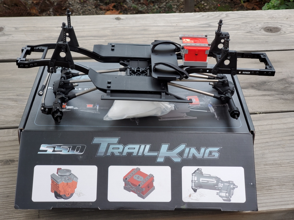

PART 2
Unfortunately, I didn't have time to continue yesterday...but, thankfully, while today's clients were enjoying "Hamilton" at San Francisco's Orpheum Theatre (and after I ate lunch), I had some time to work on the TK. I finished the links, and built the majority of the chassis.
Unfortunately, as you can see, the motor & transmission/T-case are missing. I skipped those steps (for now), as I'm still trying to decide on what ESC/motor combo to go with. I'm currently considering two options:
1) Hobbywing AXE F.O.C. System
2) Castle Mamba X (or Mamba Micro X w/ external CC BEC 2.0), and HH PP 'Standard'
I should mention that, in addition to the TK, I'll also be starting a TF2 soon (the building of both vehicles will overlap), and the same ESC/motor combos are under consideration. The TK is targeted at being more of a scale-ish comp crawler, while the TF2 is targeted to be a super-scale crawler.
If anyone has suggestions/recommendations, on these, or other, combos, my ears (and eyes) are open. Hopefully, the above info will help anyone interested in providing suggestions/recommendations. S before, more updates to follow. At the same time, the sooner a decision is made for the TK's ESC & mirror, the sooner I can start progressing forget on the build (don't want to get too far into the build without the motor/tranny in place).

PART 2

PART 4 (and Part 3)
Starting with Part 3 (completed yesterday morning), there's no photos...but, there isn't much info. As mentioned yesterday, I decided on the motor (Holmes Hobbies PullerPro Standard 2200kV), which was delivered to my work address today (along with some parts for the TF2 I'll be building, and some Landmines 1.9 tires for my Axial Capra). Additionally, I took the Trail King shocks apart, and put them back together with a little Green Slime. Not sure what weight oil to use (very open, and welcome, to suggestions), so I decided to start with 40wt in the front, and 45wt in the rear. And, that's or for Part 3
PART 4
Moving onto today's work, while this afternoon's clients were enjoying some wine, a glass blowing demonstration, and a little Bocce Ball, I finished the chassis.
Ok....technically, it's not truly "finished", as neither the motor, not the shocks, are installed, but, for all sense & purposes, it's finished. Overall, the chassis went together extremely easily, with only one problem...which was entirely my fault (I accidentally installed the rockers on the wrong sides, and upside-down...lol). Thankfully, said problem was easily corrected.
I don't know whether, or not, it's true that the founder of SSD formally worked for RC4WD, but, if he did, he's obviously learned from RC4WD's mistakes/problems, applied what he learned, and SSD is great because of it. I'm NOT saying RC4WD is a "bad" company, or that they produce "bad" products (after all, I will also be building a TF2)...I'm just saying that SSD is "better".
Getting back on-track, I still need to decide on a body, wheels, and tires...plus, if possible, is like to add some non-rotational mass weight to the front. Suggestions? The wheels will be SSD, just undecided as to which...and undecided whether 1.55", or 1.9" is more "appropriate". I will continue reading other people's TK build threads, which will (hopefully) give me some ideas, but I'm always open to suggestions in here.
UPGRADES:
I know it's probably a little early to start thinking about upgrades (or, is it?), but one I already know I'll be doing is adding the OD gears up front. Within a few months (again, I do want some time to drive the stock vehicle before upgrades are done), I'll probably be interested in replacing the axles, probably with the Diamond Pro housings, and machined tubes. Any other upgrades I should consider?
