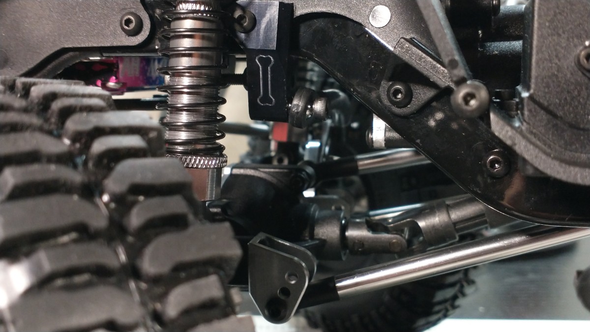

What took up a lot of time was dialing in this new panhard setup. The Club5 tie rod link is nice and beefy but it really protrudes a lot more than desired, but it works so I won't change it (yet). Here's the rest of what has been done.
Since I'm running this chassis in the shortest factory wheelbase position, I moved the Bowhouse panhard relocation bracket behind the factory mount instead of in front of it and mounted it into the frame with the nearby inner fender screw. You can also see I added aluminum link mounts (includes lower panhard mounting).
I used the factory panhard link, both sides extended rod ends, with one end extended with a 2mm spacer. I needed to mount the panhard further up and out, so I used these aluminum flat brackets to achieve that. On the left are the 2 brackets I used, and the right showing them unmodified. With the slotted bracket, it gives some adjustability to work with but I have it locked out to the max setting. Also mounted a 4-40 right angle bracket on the unused shock mount hole of the C hub to be able to mount one of the flat brackets.

Got the 2nd set of C hubs in and installed, all is good. As you can see in the first photo, the aluminum C hubs don't have the front shock mount hole which I need to utilize. So simply drilled in said area and added 4mm spacers to get somewhat near the stock C hub front shock mount.
Also my panhard setup went back on fine with the addition of a 2mm washer on the stock panhard mount.
