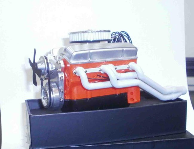

To me it actually looks like its the lack of a carburetor puts the air cleaner a bit lower making the distributor look too high. Maybe it just needs a carb or a simple spacer to raise up the air cleaner?
The intake has a raised area that would essentially be the carb height, just a square block though.
I think I agree with Ots. The size of the distributor is a bit large. maybe more 1/8th where the engine is more 1/10th to my old eyes.
Well, I've put my time in working on small blocks and I would say the proportion in the pic is pretty much correct. Just the raw size of the distributor with respect to the engine is too big. I'm working on a solution and I'll post a pic of mine clustered with some modified RC4WD parts pretty soon.
But hey, if you like big distributor caps then the SSD one is the way to go! Lol!
Ya, the more I see it the more I agree with you on the distributor being a bit large.
Looking forward to your solution.
There are a few 3d engines on Thingiverse and at least one had a distributor with it. The oil filter and other parts are close, but maybe a smidge small, so maybe that distributor would be a fit with a little modding."
Will try to get some time this week to do more details and get this one close enough for Government Work. lol

I'm no scale guy but this is a bit more of what I had in mind for my TK SB.
Fan is 3D printed - and not too fancy as I'm new at the 3D printing stuff.
Plug wires are 8 - 8.5 mm in diameter which roughly scales down to .030" to .035". This is 28 gauge wire which, with insulation, comes out in that diameter range. I think it looks a bit more realistic than the tubing RC4WD supplies with their distributor cap - that looks more like heater hose.
This will sit in my TK with a '46 Dodge body with the hood sides removed so it can be seen.
ya I agree on rc4wd hose.
These colored large paperclips look pretty good just a bit rigid obviously.
I probably have some small ga wire around here I could use. Would be easier then bending these clips up, and it does look more scale/realistic as well.
It might not matter to you but with those BB valve covers the exhaust port pattern still gives it away as a SB. Not a big deal though.
