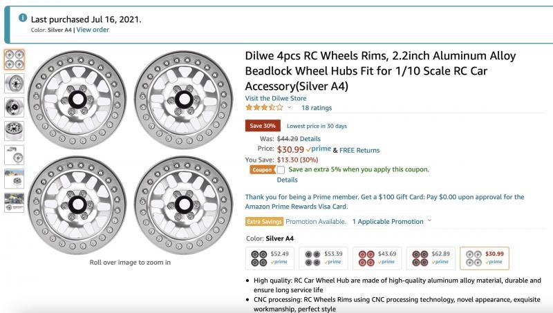

Anyway, Thanks for letting me vent. I ordered a couple sets of cheapo beadlocks on amazon. Hopefully one of them will work, just so I can get things mounted and working for the time being (I actually really like the look of the black ones). As much as I hate giving Bezos more money, you can't beat the amazon return policy.

I have a set of the cheap china 2.2s I just got. The hubs were a bit funky and wouldn't fit well on my Ryft. It's like they are made to have an insert for the axle the way they are milled out around the axle hole in the hubs themselves.
Not sure how the Vanquish ones are.
But for my set, I took out the center hubs on them and used a set of SSD hubs made for the Ryft to use Pro Line wheels on.
This worked great. The holes for the SSD Hubs all lined up on the holes for the hubs, and the center hole for the axle was the correct size for the Ryft axles.
Was able to use the stock flanged locknut to put the wheel on and it was nice and tight and no slop in the wheel/hex/axle assembly.
These are the SSD Hubs I used. They should work with any 6 bolt hub and 12mm hex, depending on needed offset. These ones do have a bigger center hole for the larger Ryft 5mm axles using the 8mm flanged locknuts.

Interesting. Looks good. Thanks for the reply.
Unfortunately ssd hubs don't fit inside the Vanquish wheel weights I'm determined to use. That's how my whole fiasco started. Both sets of wheels arrive Sunday, then I'll see what other tweaking needs to be done.
