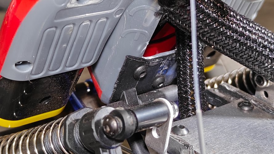

Quite a bit is being shown here, but mainly showing the hacked black piece that's screwed to the body. They Yeti Jr cage wasn't hinged in the back but I repurposed the rear setup to act as a hinge.
Here's the stock cage in position to check what I should cut off, since the rear shock mounts are built in. There was no way I could mount the shocks back in that location without sacrificing the body so a lot of it had to go.

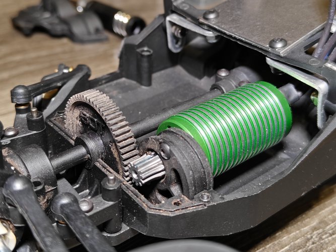

I kept a triangulated piece of the bottom of the cage because I knew I needed something to mount to when it came to the body and shocks. The piece did lose some strength though so I added some brackets and trimmed up some sheet metal. A 12T pinion was the lowest I can go, which seems to be optimal after taking it out last weekend at the monthly meet. The third pic was a totally different day, so you could see stuff like the shocks mounted to an L bracket, wire loom and all electronics in place (ESC in rear fairing).

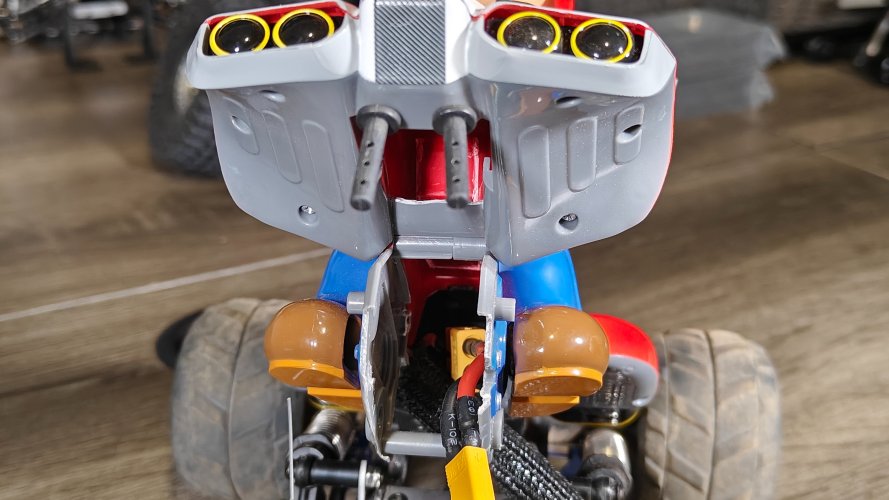

The Micro X is sandwiched and glued into the rear right fairing, which was de-cased to barely fit and a lot of trimming and grinding plastic away. You can also see I utilized the stock power switch location. Would have loved to use the stock switch cover but not enough room.
Front body posts fixed into the body.

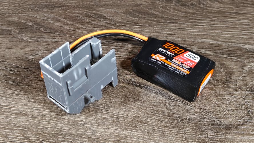

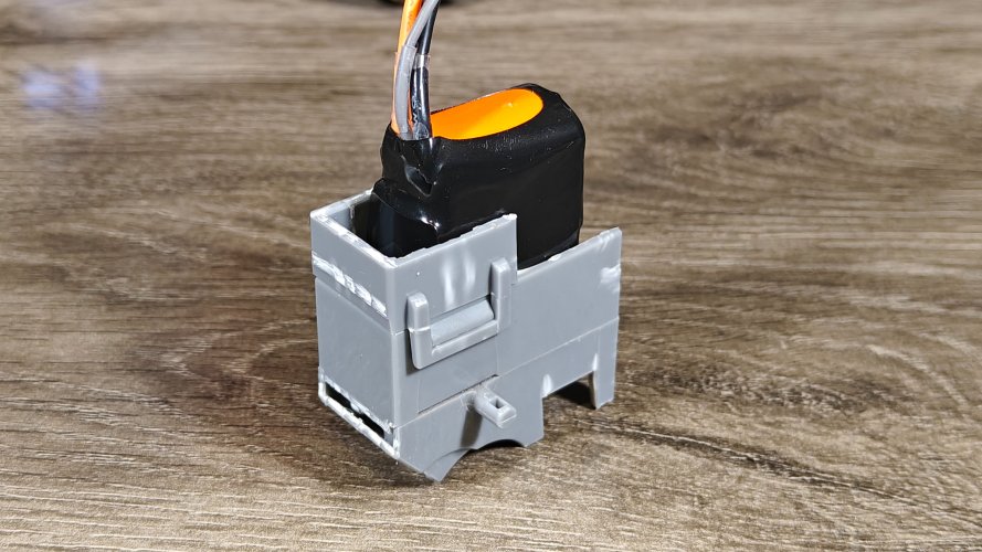

This blank gray area is where the stock servo was, which is now hollowed out and houses a Spektrum 1000mah 2S. I still want to do more massaging and fit the bigger battery in.
Another fitment solution was cutting off the pegs. I trimmed off the ends and glued them back on to cover the hole.

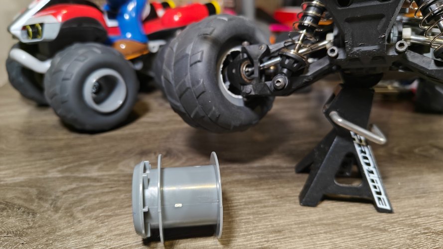

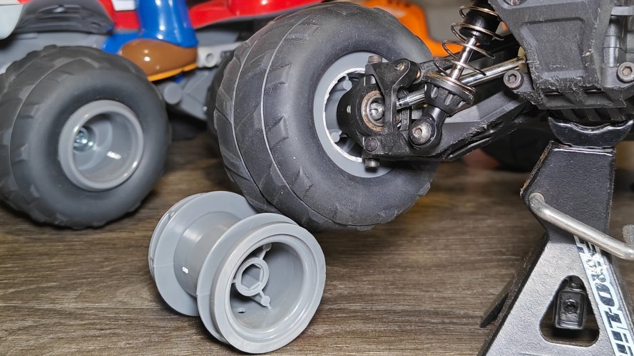

With everything done, the stock wheels took some minor work. The rears bolt on fine since they are actually 7mm (more like 6.5mm, they fit with some umph). The fronts, the toy quad is only 2wd so the wheels weren't hexed. So I bought another Mario Quad just to use the rear wheels from it. And when I test fitted them, the knuckles comes in contact with the inner rim. My solution was cut the inner rim off as the tire can still use the inside mounting disc of the wheel.
Mounted wheel is modified, wheel on desk is unmodified.
Modified wheel.

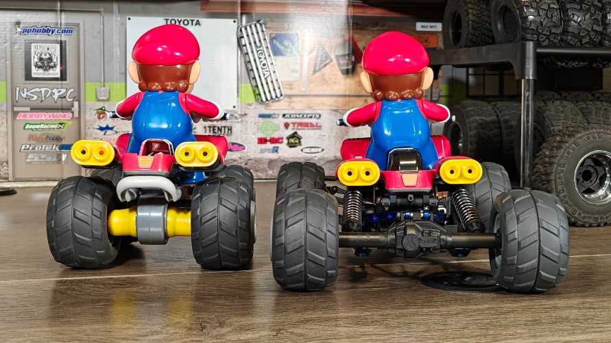

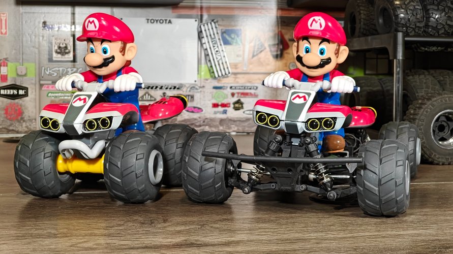

Finished pics, stock versus Yeti Jr!
RAD! DUDE! I really like the widened look. Will you keep these tires on, like, to prevent it from traction rolling ? They look like the type that will keep it "rubber" side down.
