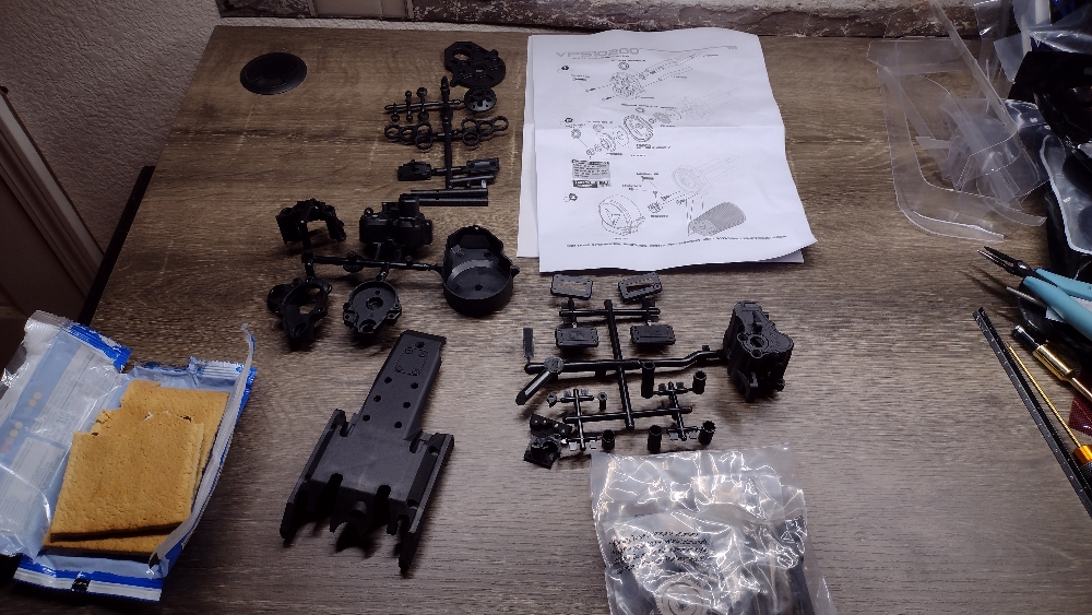

Transmission assembled, s'mores Pop Tarts snacked, mini one handed 3oz grease gun comes in handy for this stuff.
Also I wasn't able to swap to the 56t spur, as I think I need to swap to a different shaft and something else. I didn't let it slow me down so I just threw the 52t spur in and had a 13t pinion laying around so used that also. I hope it'll creep enough to my liking still.

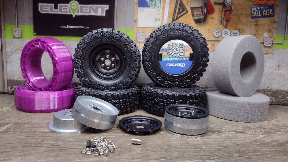

Got the wheel & tire setup going. Decided to throw in these Flub RC FlubberStufferz printed foams. With these heavy wheels, the tire already has some conforming going on so I think with the weight of the chassis on it along with a 5000mah battery, these are gonna look really deflated but I'll wait until I'm further along.

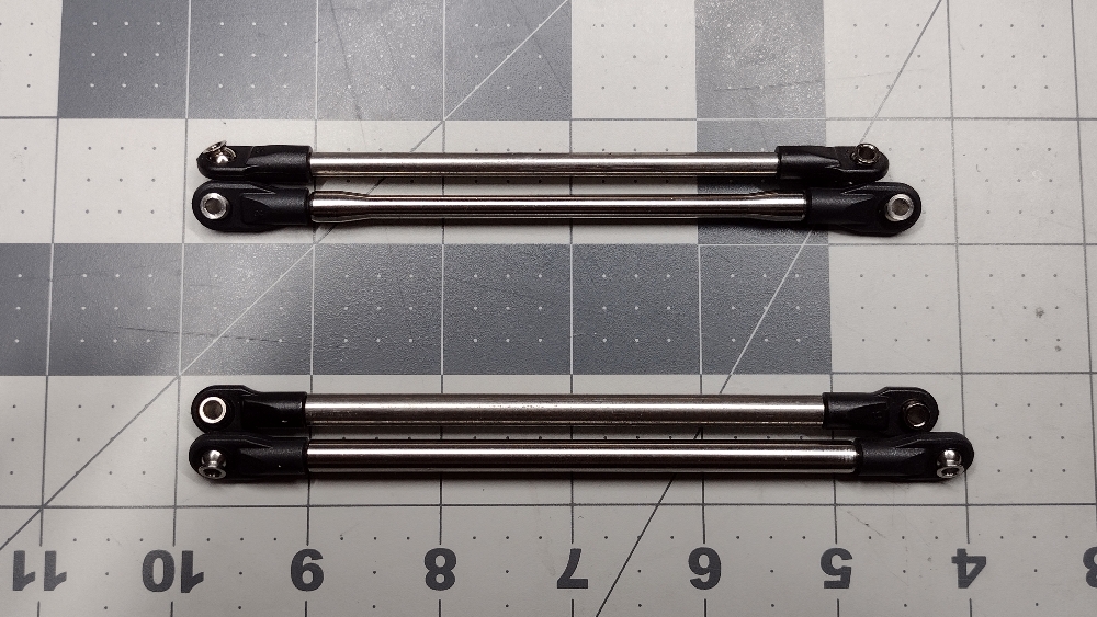

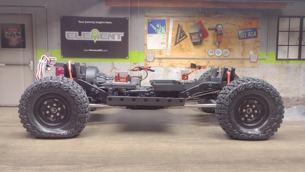

The beautiful F10T axles are done, chassis is set up with the servos and shock towers etc. I did have some links ordered to mate with the axle swap, but I'd have to use some of the portal links as well. I didn't fully think it through when I ordered these, so since I'm also gonna use the portals on another build, I'll use those stock links along with it, and for this build I ordered the Incision SS links. I wanted titanium but the Incision SS kit just makes life simple and can have them within a few days.
I'll probably build the shocks tonight, and on Tuesday or Wednesday I'll have the links in and this chassis will be able to sit on it's own weight. Putting this kit together was also very pleasing, and love that there's a lot of 2.5mm hardware being utilized. As far as the body goes, I haven't even cut it out yet. But I can say that because it's an 80's vehicle, it's gonna have a lot of chrome trim detail going on and I'm dreading it lol.

It sucks because I don't have a set of 3bros or other to compare. But like all other printed foams, just taking the tire and rolling the sidewall yourself and seeing it keep it's shape is cool. And even though these ones are for 1.9's, inside these tires they are just a tad on the shorter side.
I do have a set of YZZR inserts via Etsy purchased though and should be in my possession in a few weeks. They were promoted at $35 for a full set! I couldn't pass it up as there's 2 different stages so I bought both. Right now I think they're $43.

Yeahhh these inserts aren't gonna work for this build haha.
So since my Rock Pirate LC70 build is on the lighter side around 6lbs, I'll swap these inserts over to it and use those stock Pro-Line foams in this. Maybe even the stock VP foams in rear.

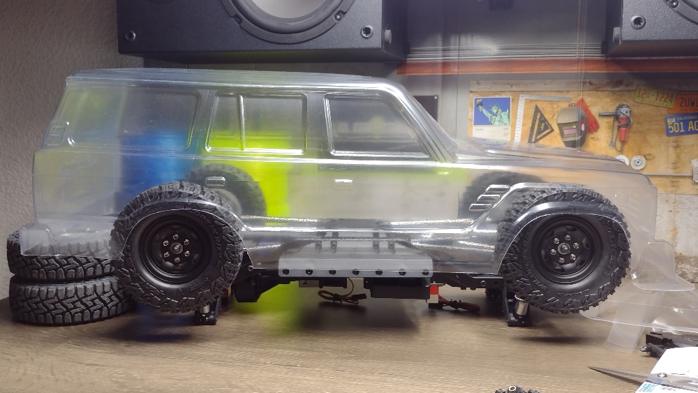

Finally cut the body out. With the Incision F10 links, the wheelbase is about 317mm, and the wheelbase on the body is ~9mm shorter. While I would normally trim the front arches for steering clearance, I'd rather not do it to this body as I want to retain the factory look still. With that said, I've put in an order to InTheWorks for rear custom links that are 10mm shorter than current. May 20th is an Amain trail meet out in Paradise CA so I'd really like to have this done for it.
Also with these wheels and 5mm hexes, depending on how I mount the body, the offset on the wheels is high enough to where the tires might be able to tuck in under articulation! It'd be really cool with a set of 1.55s and 3.5-3.8 sized tires with a stock height setting but I really want to utilize these tires with this build. Who knows, I might do a tad bit of trimming to the arches but keep them to shape (like how my other builds are), just to make them a bit bigger but that's it.

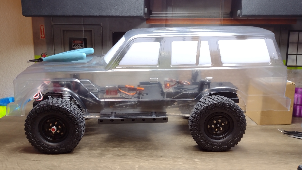

Didn't want to update yet but I feel like it's necessary even though it's not much.
So I got my shorter links in last week and installed them. Quick back story when I put my order in, I had ordered them with the measurements at 5mm shorter instead of 10. Shortly after I put my order in, I emailed them with my invoice to make the links another 5mm shorter. I never got an email back about that for confirmation. Sooo lesson learned, confirm exact measurements you need with your rig before purchasing! [emoji23]
I still put the new links on to see the fitment, and yes I am still not satisfied so I put another order in and we'll play the waiting game again. It's a little hard to see with the unpainted lexan but the wheelbase is still just 4-5mm off.
As far as body progress goes, as you can see it's got the window masks on but I need to mask the head and taillights still. Other than that, I cannot get any other body related stuff done until I have the official wheelbase dialed in when I get those new links. I then can work on the body mounting (I'm thinking utilize the Phoenix setup). So since there will be a long few months for the new links, I'm gonna go ahead and start my GShot Hilux build...
