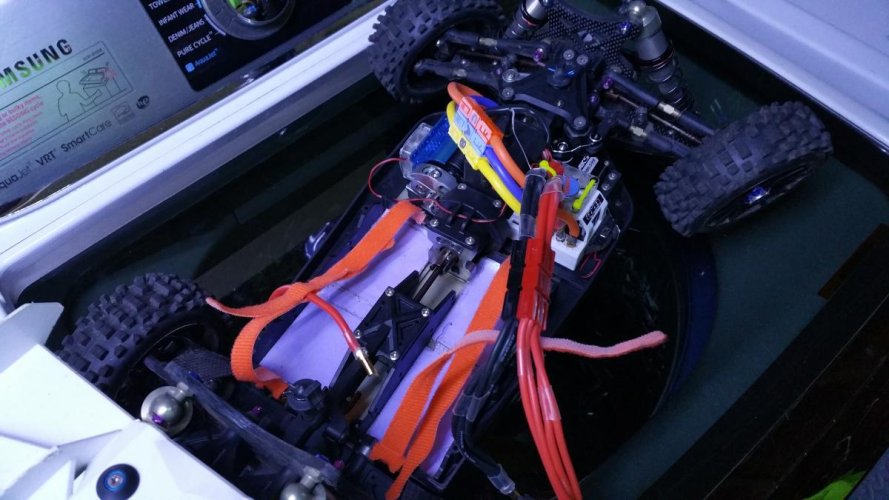

pic1,

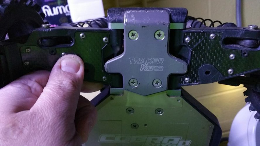

anyone out there have a SPARE skid plate they would sell? this company is no longer making these ?
(these are the TRACER SRX8e SKID's )

squezed in 50 tooth serpent composite spur gear coupled with 13tooth pinion. (stock is steel 44 tooth) Lighter rotating mass gear, titanium diff screws AND pins, coupled with a 3000kv 550 motor. Along with MANY other lightweight mods( the SRX8e is a stock HEAVY pig!!!) this thing FLIES! 4s 7500 batteries last little over 10 mins, and if your really hard on it, can get a thermal limit on the RX8 esc.
To fit the big spur, required a true extreme mod. first making 2.25mm carbon fiber shims under the diff supports. Needed CF as the aluminum shims i made got warped from the forces on the gear. I had to increase the upper support/cover height by the same. using the normal battery configuration gear cover, i cut it up and used the support braces as a shim spacer. To keep the rigid/strength of the saddle cover required 2.55 stainless washers (thank you dremmel) with titanium screws. end result is a now more spur gear choices.
Also added a easy way to remove the diff, as anyone knows these cars are a PIG to remove the center diff.
