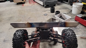

The chassis is a 1/4 thick piece of aluminum that was cut to length to ensure the wheels were within the wheel wells.
I made a set of bumpers, first iteration:
2nd:
I gave it a swiss cheese treatment, and this is how it mounts the hood to the hinge and bumper assembly
Mocked up
