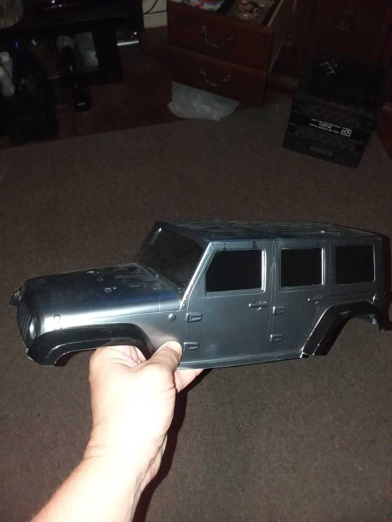

Thats very kind of u dez! Its great to see young ones get into this hobby, keeps them out of trouble n in the fresh outdoors, plus theybget the exercise they need. I was goina say, ive got a jeep body id donate for the lil guy if needed. Looks like u got him a good start into this addiction lol. Hes goina b so suprised n excited. Youre a good man dez!
