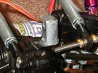

It started to become apparent that I needed new Upper Link Mounts for my clod. The abuse of BFTs and lathe motors running on two batteries was starting to really wear them out.
No matter how much I tightened these down, they always would wobble back and forth.

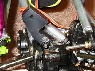

Once you have removed your old mounts, the first step is to take the 4mm bolt and aluminum sleeve and slide them up the bottom of your case. Then screw that into the threaded hole in the bottom of the link mount.
Next you will need to remove the top forward-most (Or back-most, depending on which side you are doing) and replace it with the longer 3mm bolt supplied. |

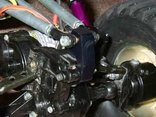

Line up the link mount with the hole, and bolt it down with the hardware supplied. With both these bolts tightened down firmly, there is absolutely NO play! Even when I first got my aluminum upper link mounts, they had enough that I was disappointed. Knowing of no alternative, I accepted it. But with the G-Made link mounts; there is no such thing! |
At first; when I heard of the mounts being made from nylon, I was a bit worried. I've snapped a solid .250” link in half before, so I need beef in my suspension! But this sucker measures out at a huge .500” wide! And with a 4mm bolt and a 3mm bolt on the G-Made unit, instead of just a single, small pot-metal 3mm bolt, I don't think I have to worry! |
Beefy!!

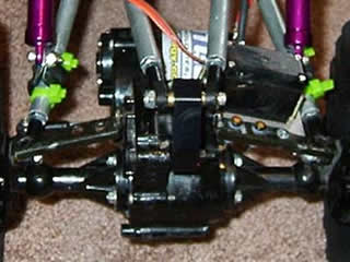

These mounts look great too, I thought they'd look rather bulky on a relatively small clod case, but they blend in really nicely. I highly suggest getting a pair of these upper link mounts for your clod.
