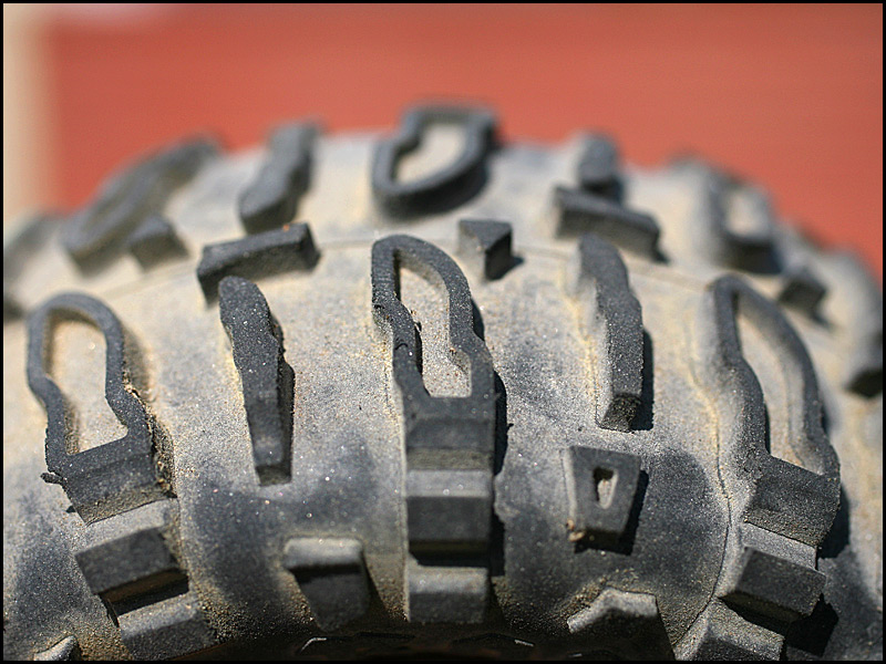

You can see from the photos, the tire design looks almost identical to Losi's LST tires. The exception being the larger lugs are "hollow" allowing yet another edge on the tread to grasp for traction. Losi's "Blue" compound feels very similar to the well-know M2 compound. This brings up my only concern which is how long will these last? My guess would be not quite as long as the Moabs and Mashers. The side lugs will be the first to wear off I would assume. Not a big issue if you like the performance of the tires enough for competition use. The Rock Claws' beads are much beefier than the Moabs/Mashers. The closest comparison I can make is to the Imex beads.
treads
Very much like the LST tread pattern except the large lugs are now hollow to offer more traction.

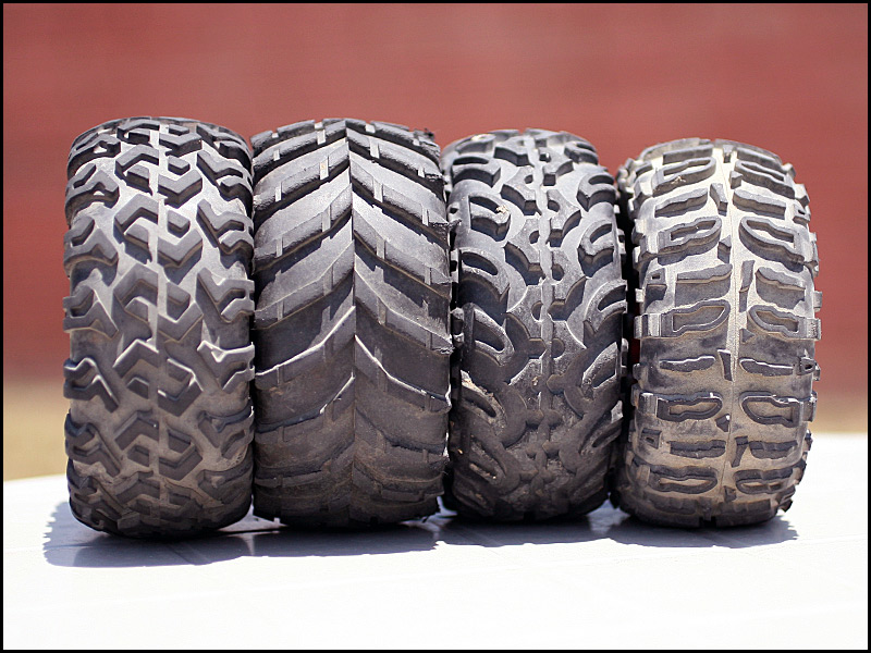

I didn't take exact measurements but I can compare them to tires that you most likely own. The Rock Claws are about ¼" shorter than both the Moab and Masher 2K 2.2 tires, ¼" narrower than Mashers, and ¼" wider than Moabs. The photos and appearance of the lugs are deceiving. They are actually just barely shorter than the Pro-Line tread. The most interesting thing about these tires to me is the actual main carcass is very thin. This allows the tire to be much more pliable than what's available currently. They feel just like a 2.2 racing pin-type tire carcass to me.

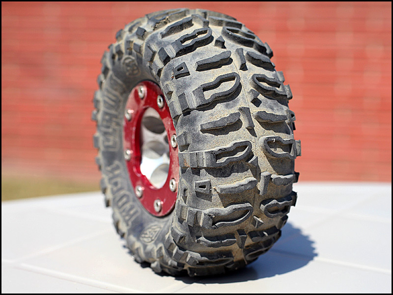

losi
Cutting some diameter off the foams helps these very thin tires collapse nicely. I am not putting any pressure on the tire, only holding it.

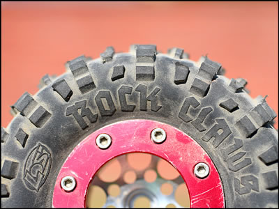

losi
The Rock Claws look great mounted up to the Super Narrow Beadlocks. To me, the side-lugs look alot like BFG Krawlers!

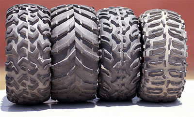

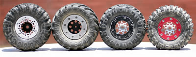

Here are a couple size comparison pictures. (L-R Axial Rock Lizards, Proline Masher 2Ks, Proline Moabs, Losi Rock Claws)
