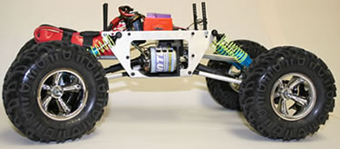

Here you can see the transmission laying on it's side. Notice how the heavy motor is placed almost directly onto the skid plate. The only modification I made to this chassis can also be seen in this picture. The shock on the right is the front shock, and I re drilled the hole for it to make it lay at about the same angle as the rear shock. The reason for them coming out to different lengths is I run shorter links on the front axle for a 60/40 setup.
This close up of the rear axle shows the RBX built upper link mount, and the rear steer lockouts I built, at the comps we hold here in Colorado we do not allow rear steering in the 2.2 class.

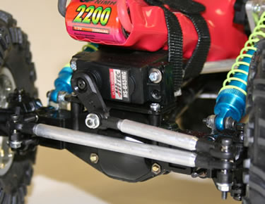

Here you can see the front axle with the custom tie rod and drag link made from 1/4" solid stock aluminum. I am running a HiTec HS-645MG for steering duties, and I had Cheapbatterypacks.com build me a custom 2200 Mah 7 cell pack for just a little extra punch.

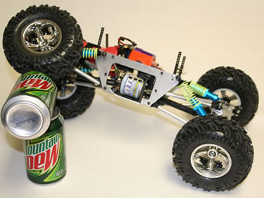

The RBX sports a very decent amount of usable articulation.
