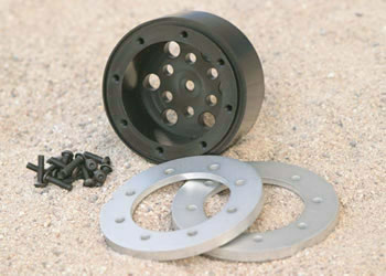

We got our hands on a set of Erickson 2.2 beadlocks from Montana Scale Designs. The set of four wheels came nicely packaged and we tore into the bubble wrap to find some very trick parts. The wheels come in five different patterns (we got a Double Six set) and the wheels are machined from solid black Delrin® with a beefy 9.5mm thickness. The finish on the wheels was nice and smooth with some slight milling swirls evident on the machined faces.
Since these were designed from scratch to be a rock crawling wheel, they come with a narrow width of 33.2mm (about 1.3”), not including the beadlock rings. Also, to push the track width out a bit, the wheels were designed so the wheel hex is flush with the backside of the wheel. The hex sockets look plenty sturdy, fits a wheel hex snugly, and there are two small holes in each wheel to allow for some tire breathing.

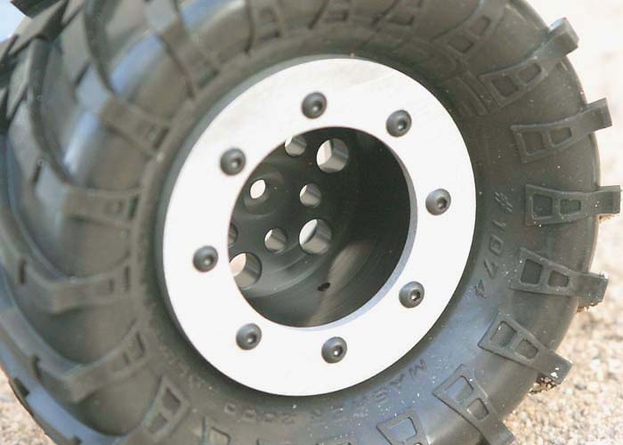

Beadlock rings are used on the front and rear faces, and are machined from 4.8mm thick 6061 T6 plate. Each heat treated aluminum ring is held to the wheel using eight 3 x 13mm button head cap screws. The rings come with a random brushed matte finish, or may be ordered powder-coated as well. Our set included more than enough hardened black screws (stainless optional) to build our wheels, with spares left over. We can appreciate that.

We held the tire in one hand and lightly squeezed its outer diameter while pushing the wheel slightly from the backside. This pulled the opposite side tire bead down onto the wheel step and we used a finger to gently push the tire bead and seat it on this step. By using more or less squeezing pressure on the tire and wheel, we were able to adjust how well the bead seated. While continuing to hold these, we laid the first beadlock ring on the wheel and installed two opposing screws, and snugged them down a bit. With this we could release our grip and install the remaining six screws. Next, we worked our way around the ring and tightened the screws a little at a time until they were all snug and even. Finally, we flipped the wheel over and repeated for the other side.
We were surprised at how smoothly the screws went into the wheels, thinking they were going to require more effort on our part. We had one screw that went in snug, but simply found some debris on the threads when we pulled it back out. This may have been leftover machining debris or something we got in the wheel ourselves. All the other screws worked perfectly.
With the tires mounted and beadlock rings snugged down, we grabbed and pulled on the tires trying to separate them from the wheels. No dice. We gave up, thinking we'd tear apart a new set of tires before the wheels would give up the tire bead. No fear of these letting loose.
