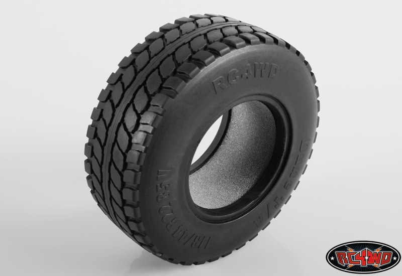

Wouldnt mind trying out the RC 4WD tires also but I think they would be a little bit too small, anyone have some pics of these fitted?
Might be OK for an indoor pavement type track setup?
The SCT tyres shouldn't look too bad, the Yeti TT tyres at 4.72" are some of the tallest 2.2/3.0 , most are only 4.3"
1.9 size wheel & tyres (similar size as you looking at) look perfectly fine on both the RR10 & Wraith, though they really can do with a slight shortening of the wheelbase & a narrower axle to bring the proportions back.
