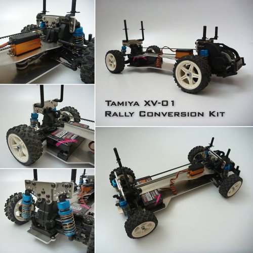

Probably just a less complicated gear box and steering assembly. Maybe something similar to what the Czech guys came up with, with the dual metal plates for the chassis.

btw, I want to see how the steering is setup on the monkeyracing xv-01 chassis....
Do you have a picture or link of that?? I´m curious!
Regarding a dream xv-02, I think IMO it would be just like the current XV-01 after all the official fixes (long dampers, higher suspension mounts), but also a new main chassis part for short lipos, where the battery storage box is located in the middle of the chassis. I would also like to have a limited slip center differential or some way to adjust F:R torque split.
Here's the MR design... They posted this image on their FB page.

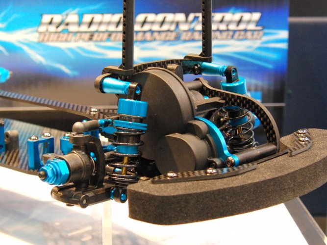

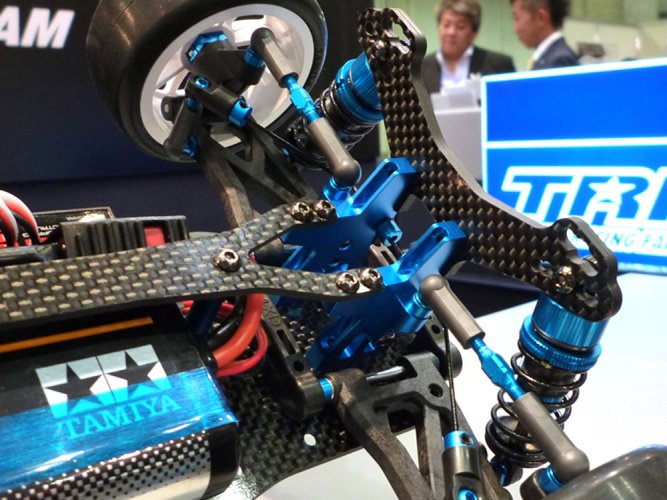

These are pictures of the upcoming Tamiya FF-04. The FF chassis line is FWD, so this is a FWD car. But I figured it's worth showing here... I see a good bit of xv-01 in there...
