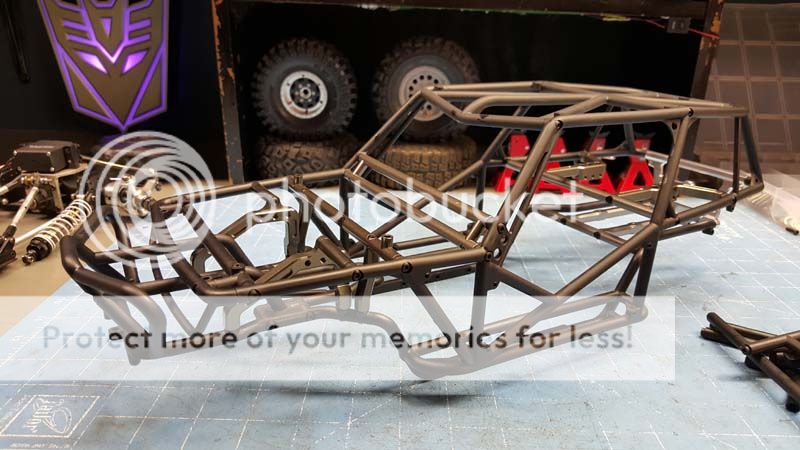

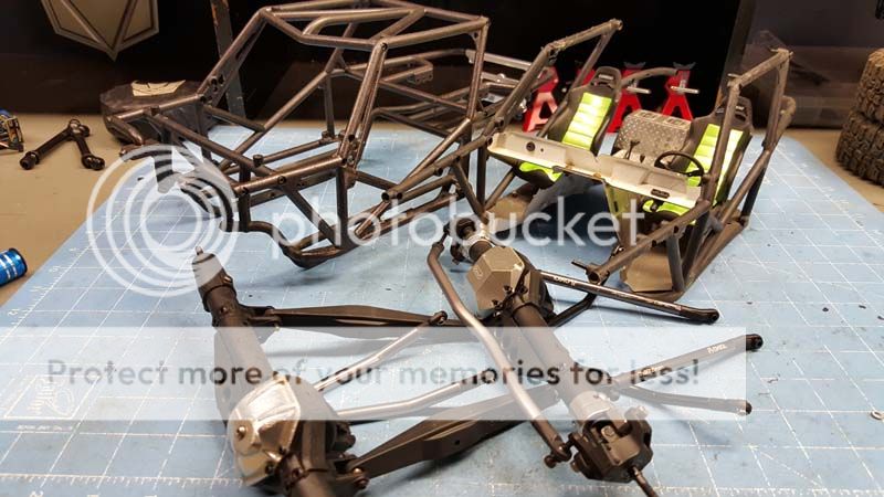

New chassis was needed, both originals were too badly cracked.

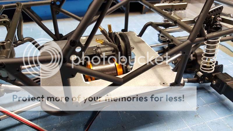

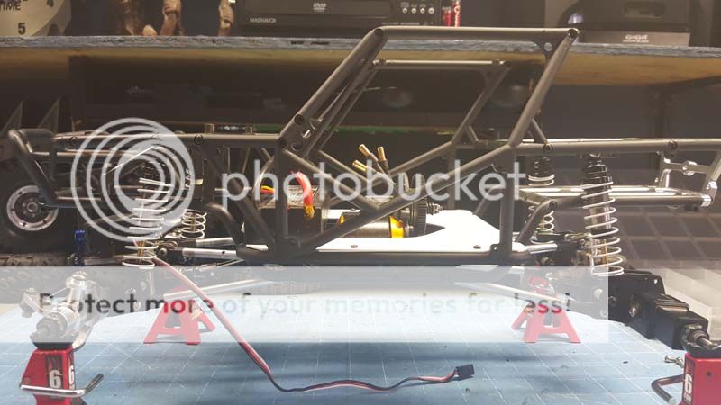

Pulled the trans and found all steel gears in nice shape. Case was warped oddly though...had a new case, and cleaned and re-lubed. Motor came off the classifieds here - no idea what it is, but it's bigger diameter than a 500 motor- maybe a 600 class? Had to do a little shaving to get it in there, but it fits. Torque monster for sure.

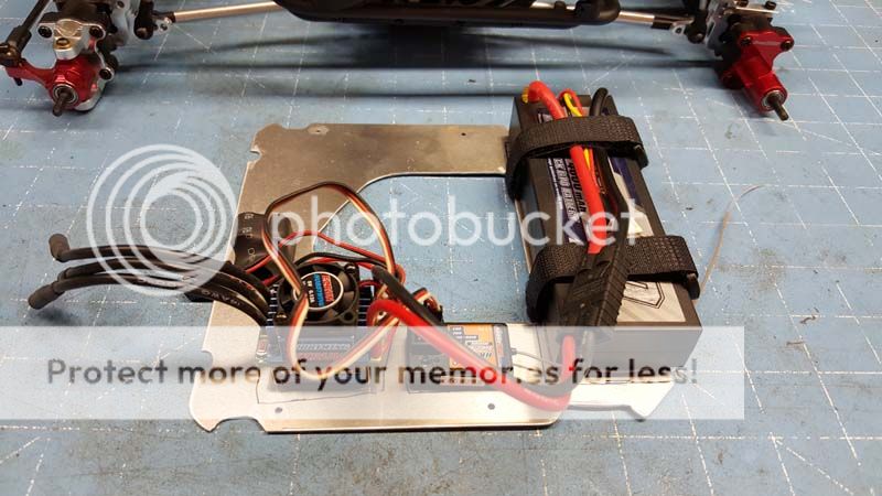

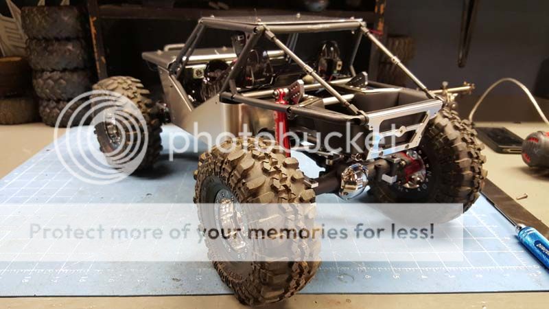

Fabbed up a battery tray and electronics plate and put them as low in the chassis as possible. Everything is hidden under the Spawn interior. Takes a little dexterity getting the battery in and out, but it's not as bad as I thought it would be.

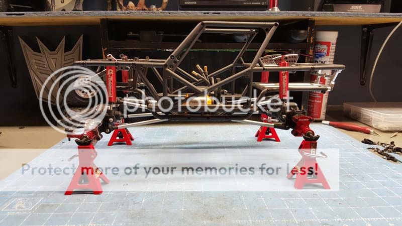

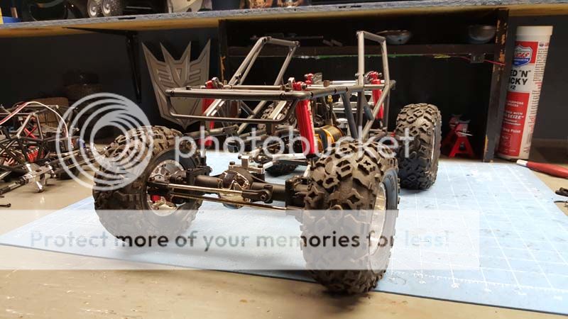

Originally had Wheely King axles on here, but after breaking an RC4WD CVD after a whopping 27 minutes of trail running, I'm a little hesitant to drop $50 to get them running again...so in the meantime, I put on some R1 axles and ended up liking those a bit better. They already had some aluminum goodies on them and were just sitting on the shelf. Had to figure out the links and some sort of CMS set-up, and ended up with a slightly shorter than stock wheelbase.

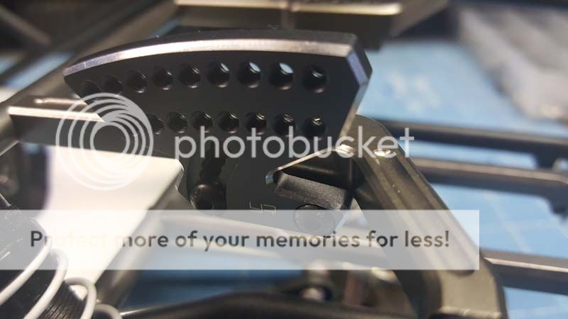

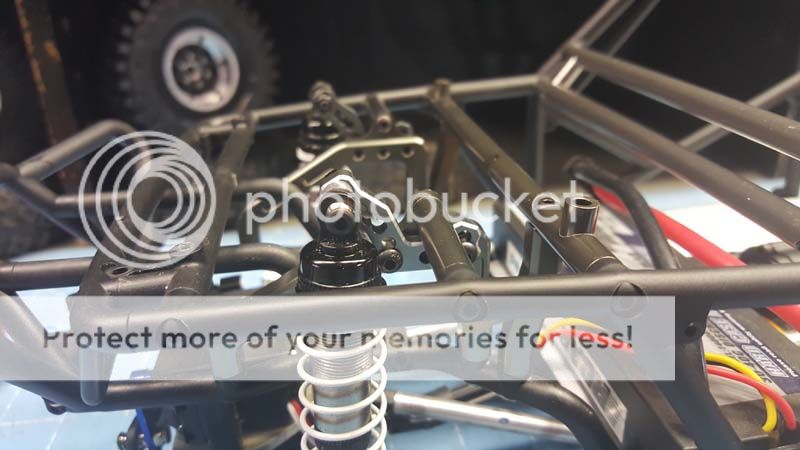

I used Yeah racing shock mounts as I needed a little flexibility in where I mounted the shocks to get the ride height down. Pretty nice pieces.

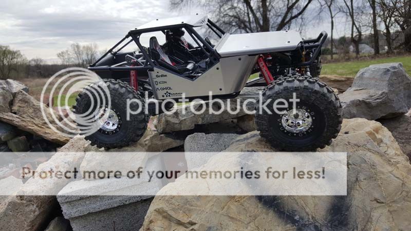

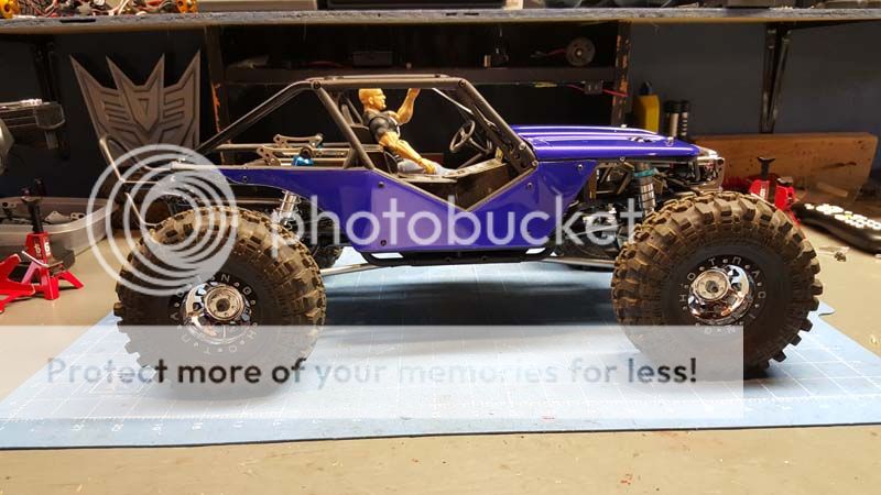

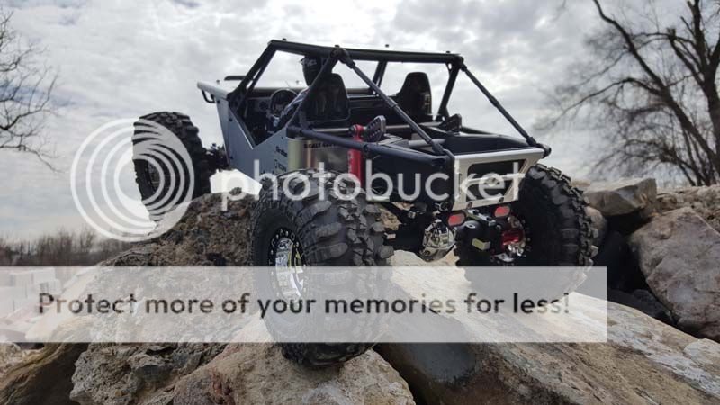

Slapped together the body panels and hacked off the back of the chassis...came together pretty quick. Not a show truck by any means

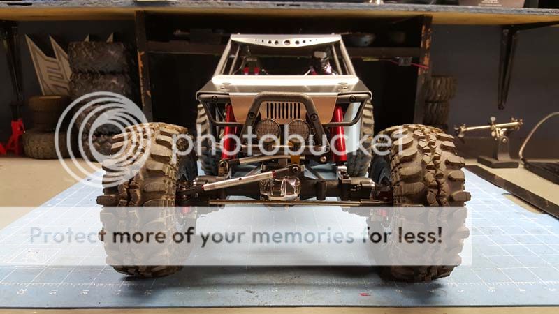

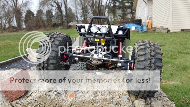

Test run time...Did ok for the first time out. Gobs of center clearance and lots of torque, even on 2S. Needs some tuning, has quite a bit of bump steer and the shocks need some heavier oil. Pretty happy with it for a basket case rebuild.

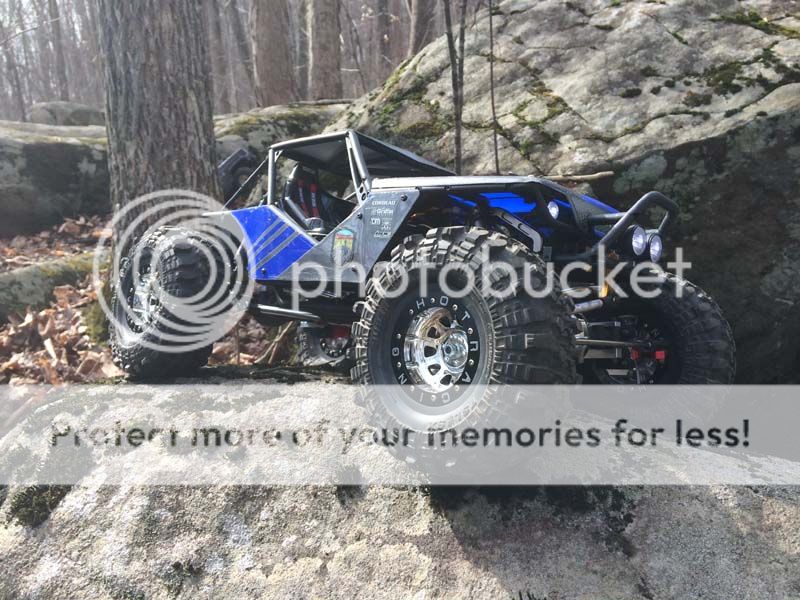

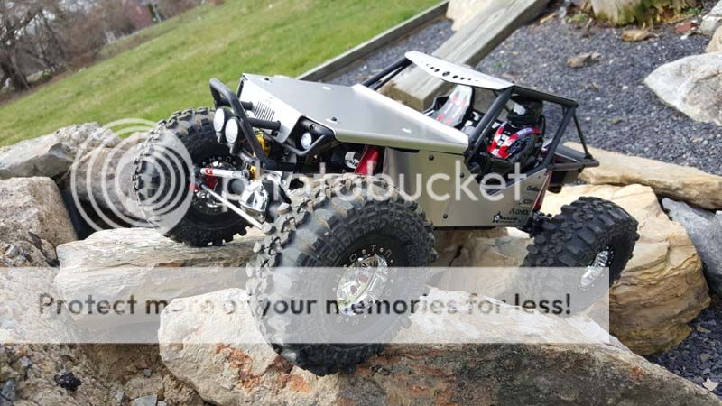

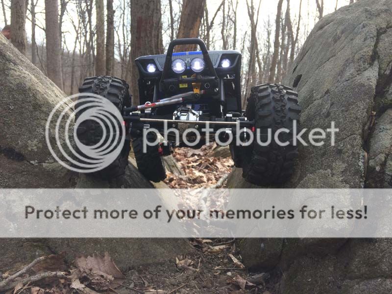

Finally got this rig out on a trail run...wow, very impressed. Stable and climbs well. Underbelly clearance is amazing of course. Steering is iffy though, and I've got to gear it down. I can't say enough about PL TSL's...I ran 4 sets of tires today and the TSL's gripped everything, all the time. These are stuffed with PL 2 stage foams (original version) and they are a perfect match for this truck.
Didn't get a whole lot of pics, was having too much fun!
