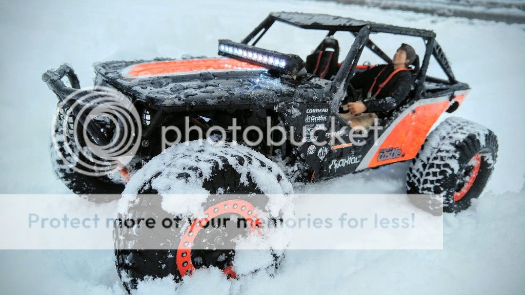

Gave the truck some new LockedUpRC wheels and rings that I panted to match, did the fastback mod, and took it on a trip to Vegas/Utah/Arizona in March of 2014.
At the Grand Canyon. April 2014.

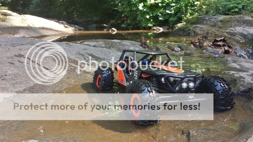

Then gave it a "I can see everything anytime" upgrade with a GearHeadRC waterproof light bar and some custom rock lights.

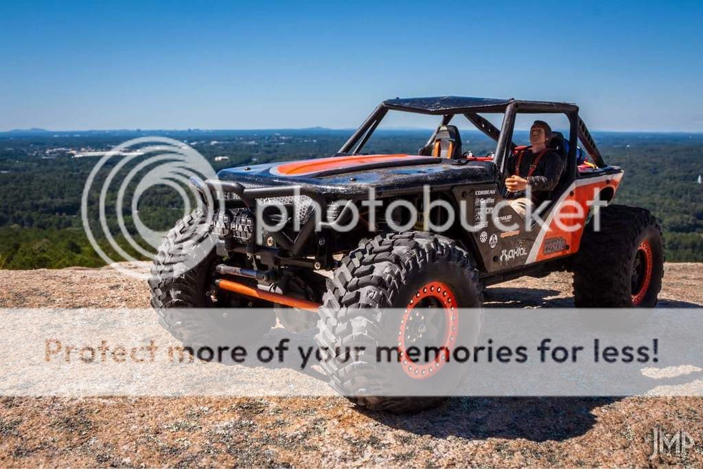

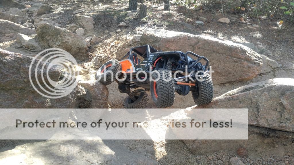

I took it to PA in 2016. This was at Rausch Creek Offroad Park.

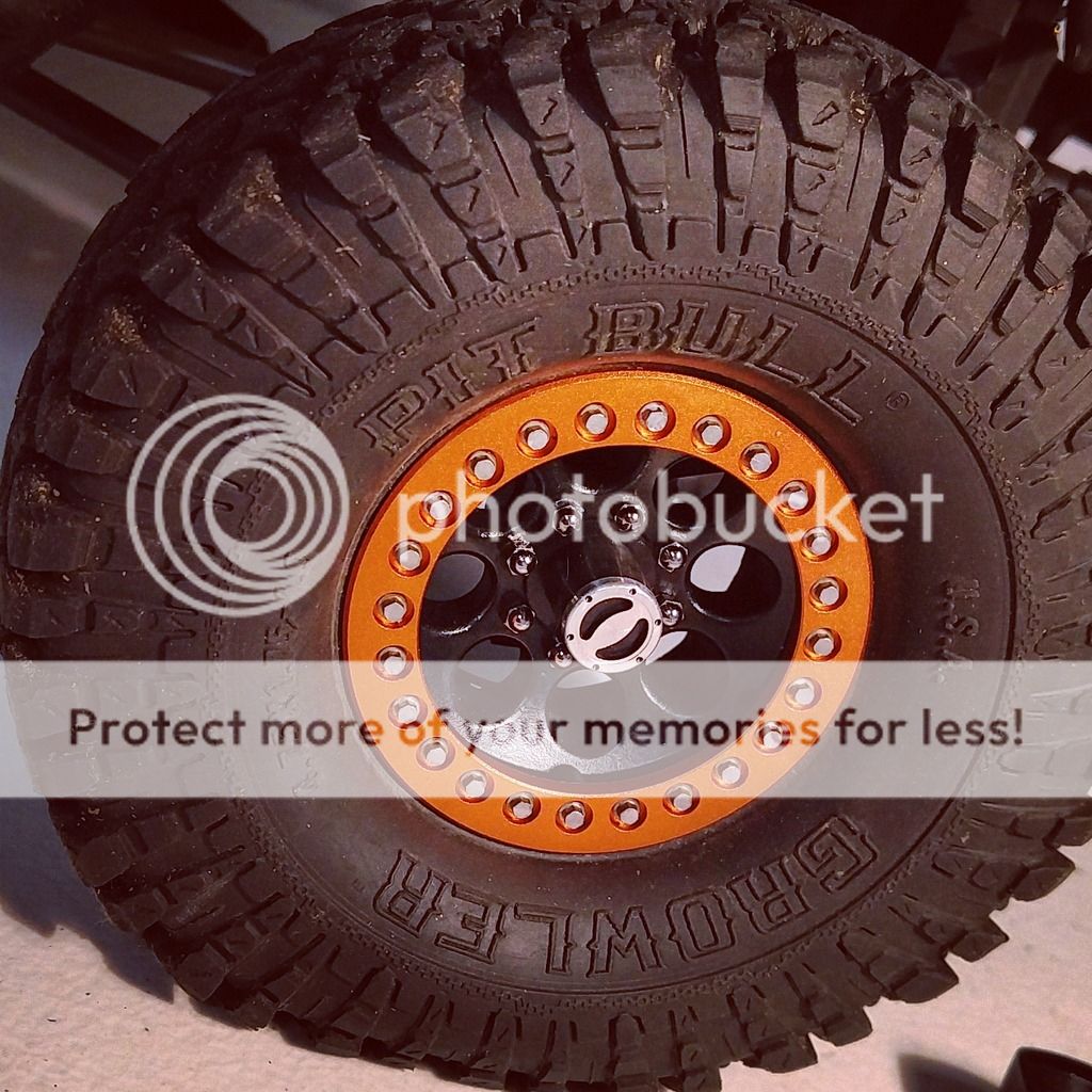

Picked up some second hand 1.9 PitBull Growlers in late 2016. Still running the 2.2's.

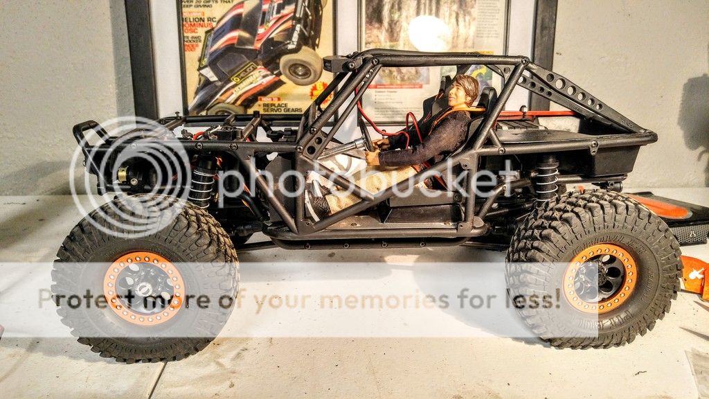

The first thing I did was repurpose some nearly 9 year old 1.9 Axial 8 Hole wheels with some LockedUpRC Agile rings and scale hardware. I drilled out the faux lugs that are molded into the 8 Hole's and used the acorn bolts in their place.

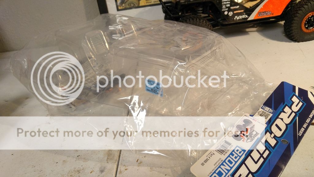

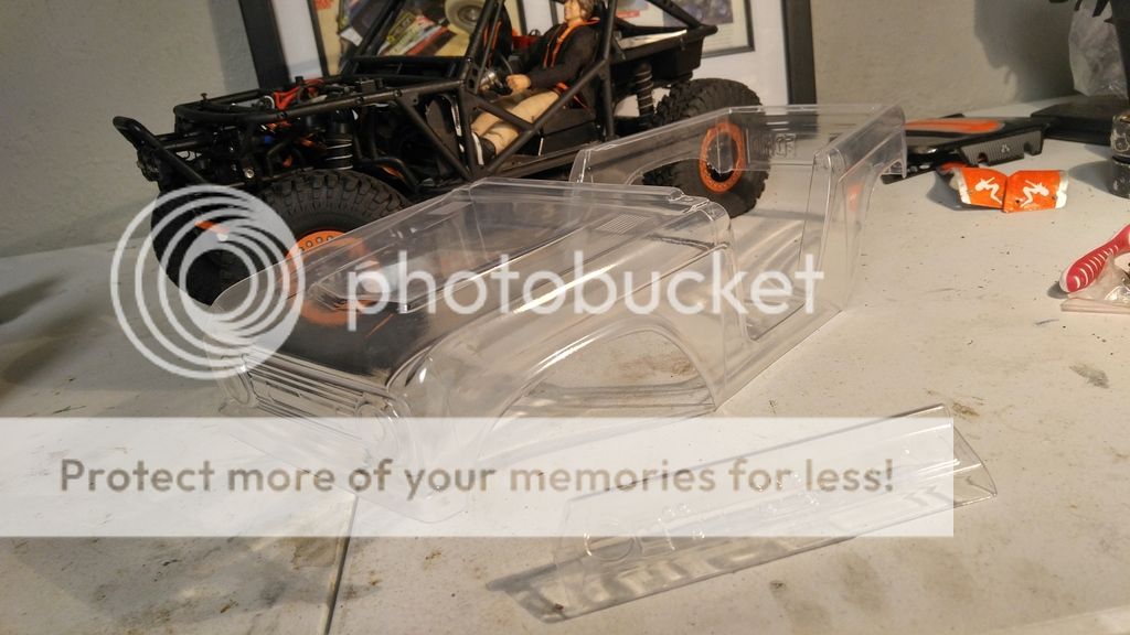

Then the body and paint showed up. Going with the Pro-Line 66 Bronco that's meant for the Deadbolt. Still haven't fully decided on a paint scheme, but I'm gonna keep it fairly simple with a two tone and some accents.
Got the wheels all finished up. There's a little touch up painting to do on them since the paint is old and I don't think I prepped them that well. I've got new Crawler Innovations Lil' Nova foams that should be here this weekend. Was only running a 2.2 CI inner with the 2.2's and stretched 1.9's.

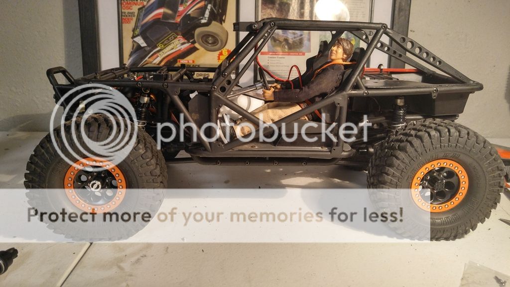

Tonight when I got home I got rid of the old panels and started sanding the cage to smooth up the years of abuse, then gave it the semi-gloss stain treatment.

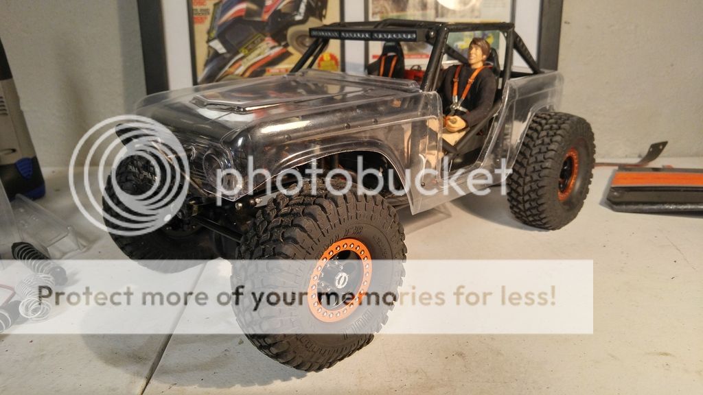

After that I cut the interior out of the Bronco body and trimmed it and the dash out. I'm hoping I can somehow make this dash work with the Wraith interior because it's a really nice mold and I'd hate to waste it.
This was as far as I got tonight. Still a bit of trimming left to do on the body before it will fit properly. Hoping to at least get it painted this weekend.

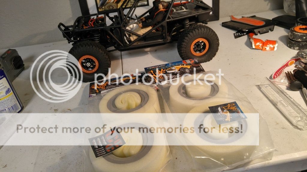

I ordered some CI Lil' Novas in 4.50" with Comp Cut inners. Went with soft outers up front and medium in the rear.
Before with just the 2.2 inners.
After installing the new foams.
Like I said, not a major update, but at least I got to spend some time on it.

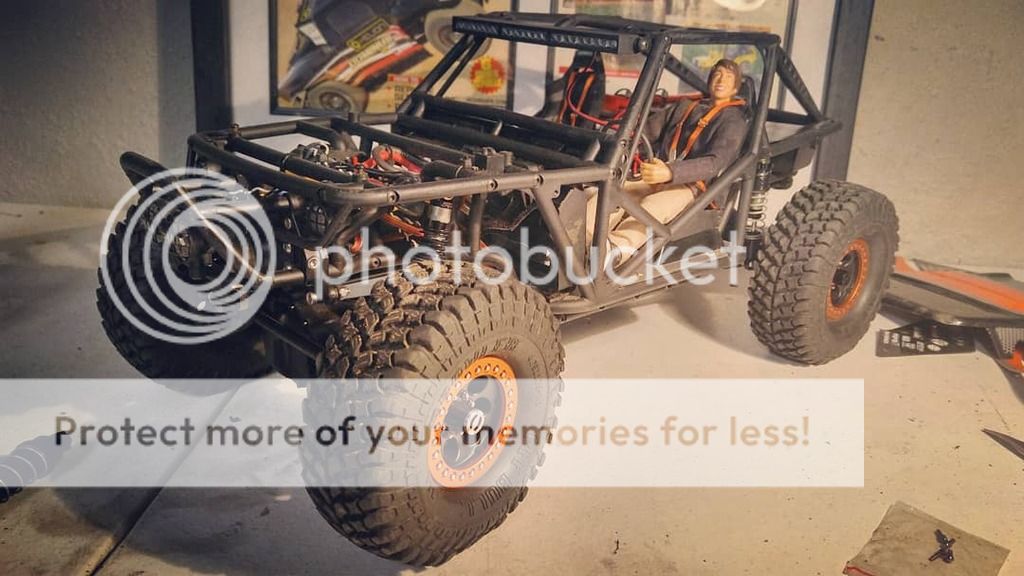

Was able to get a little painting done last night. Now the truck no longer had multicolored links. Also cleaned and rebuilt the shocks, so now she's sitting at her proper height.
Hoping to bee able to get some more done this week after work.
Got the links all painted in a semi-gloss black. Need to order a new servo horn. Tried trimming the current one down and trimmed too much causing a bit of a clearance issue.
Cleaned and rebuilt the shocks. Running 20wt in the front and 30wt oil in the rear. I'm looking into either painting the shock bodies in a gold anodized, or going with some aluminum components.

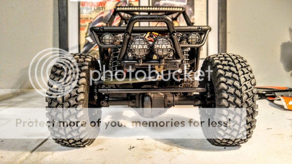

Finally got the new Pro-Line 5" light bar mounted. Need to still run and secure the wire. Had to modify the mounts to get them to work where I wanted, but I think it turn out close to perfect.

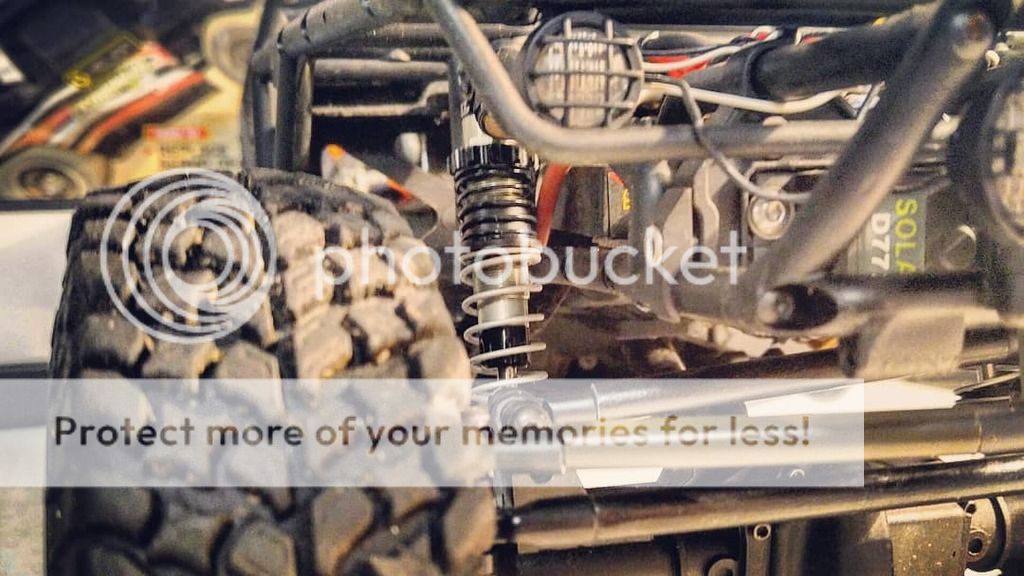

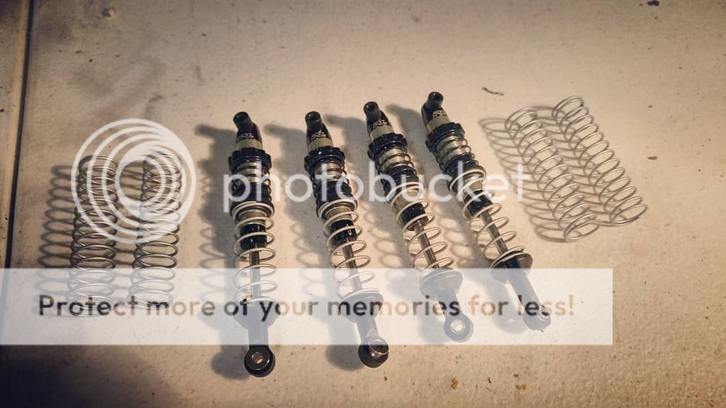

Picked up some gently used Pro-Line 95mm Scaler shocks and got them cleaned up, re-oiled, and mounted last night.
Curious to see how they'll perform. I added the bump stops from the stock Wraith shocks to keep them from bottoming out. Also used the longer rod ends to make them 95mm so I won't lose much ride height. Thinking I'll have to adjust the preload to get a little more clearance, once the body is on, so that the Growlers won't try to snack on the Bronco fenders too much, even though I've heard they're quite tasty. Hoping to get time to start on the body this weekend.

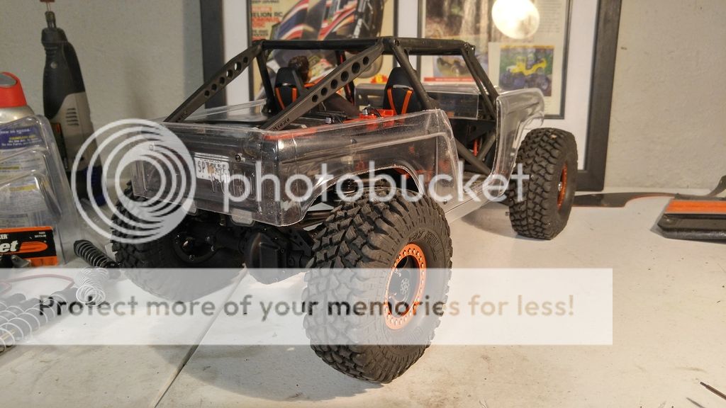

Today I was able to get the body mounted. Had to do a good bit of trimming to get everything to fit properly.
I was a little skeptical at first that it wasn't going to fit right, but I kept trimming certain areas and refitting it.
I initially wasn't overall happy with the position of the body, so after dinner tonight I came back and repositioned the body a little lower on the chassis. I'll definitely have to add some preload to the shocks to raise the ride height, otherwise the Pit Bulls are gonna start violently chewing on the fenders.

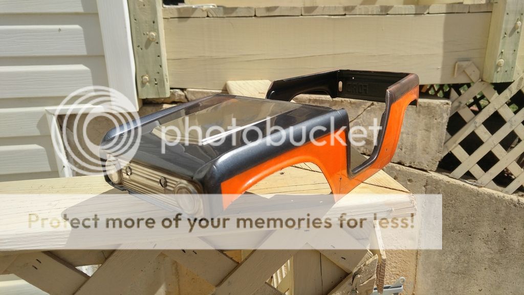

We finally have some paint! Wasn't able to work on the truck until towards the end of the week, but I managed to get a little bit accomplished. Follow along, won't you?
I played around with some colors to try and find a shade of orange I was satisfied with.
I ended up laying down a few layers of the fluorescent orange, then a couple layers of copper, and finally a backing layer of silver. The end result gave me close to the shade of orange I was after. For the actual color on the truck I'm probably only gonna use one layer of copper to help keep it a bit brighter orange, yet still slightly metallic.
I was able to get a little more done tonight. I finished sanding on the body and got the first stage of paint on.
All masked up, for the most part, and ready for some color.
Painting stage 1: Successful. The gunmetal turned out really well backed with silver. I decided to stop for the night because I didn't want to rush it. In between coats I set the preload on the new Pro-Line scalers, so once the body is finished I'll be able to see if it's enough. Kinda just went with a baseline of 1cm all around.

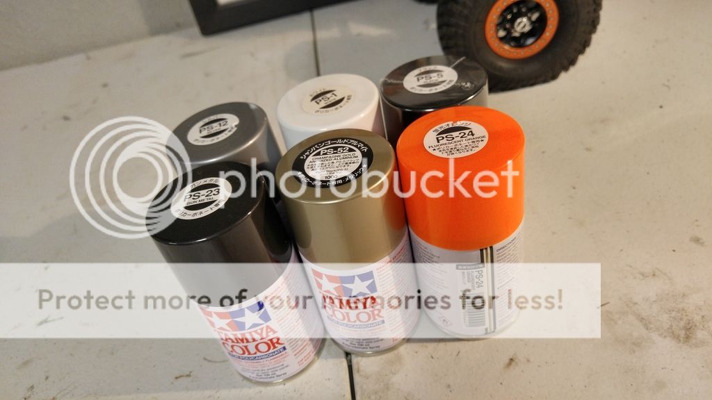

I started with a Tamiya fluorescent orange base.
Then added a couple light coats of Tamiya copper.
Then finished it off with some Tamiya silver.

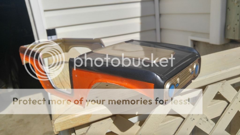

Was able to get some painting done yesterday. Painting stage 3 mission status: Major Success!
Finalized the paint job with the last color, the Tamiya champagne gold anodized.
Laid down several layers of the gold, backed it with black, and then backed the whole body with Plasti-Dip.
Before the Plasti-Dip was fully dry, and before I started removing the overspray film, I had to see what it looked like on the truck. This pleased me.
Removed the overspray film and put it back on the truck for a few more pix.
I'm loving how the body out. There are some minor flaws, but it still turned out great. I've still gotta mount the light buckets and get the decals on. Still debating on an idea for opening the hood. Mocked up the dash, but Haven't given it anymore time. Hopefully it'll work out. Still a good bit left to do before I put a pin in it.

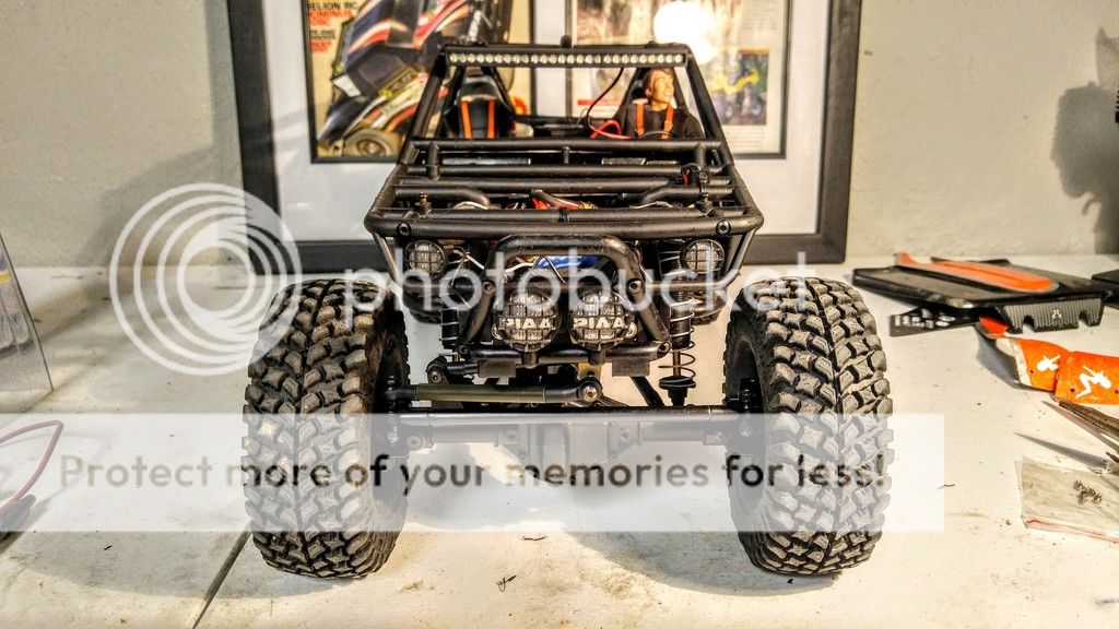

#Wraithlift debate.
Had some time to work on the led buckets for the headlights and turn signals, but I've been debating on just using the 2 light pod leds on the bumper for the turn signal leds and just eliminate the light pods. Wanted to sort of put it to a vote.
With pods, or without?
Let me know what you guys think. Stay tuned kids! "thumbsup"
They look good installed, but I'd be concerned with how durable they'd be up front in the middle of the bumper...
Lovin' the paint, body, and wheelset!
