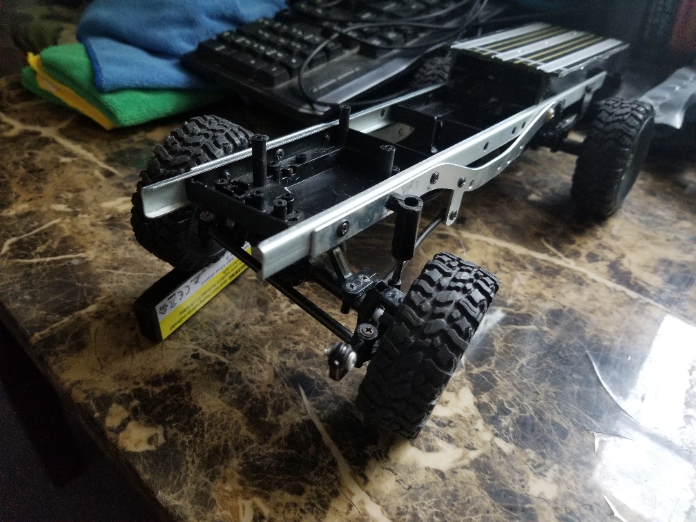

So I recently purchased the metal transfer case/370 motor combo meant to go in the C14/C24 frame, and had a quick thought. Has anyone else swapped this combo into a B1/B16 frame? If so, how'd ya do it?
Reckon I should also mention that I'm converting the front suspension from leaf spring to 4 link using a C14 assembly.
Here's the current idea:

So after a week or so off (mentally checked out and had forgotten that I was posting on here), I got the chassis done.
Turns out, if you lop off a decent portion of a C14 frame, you can make a B-series have a 4 link front.
Got that all squared away, now time to build the motor/gearbox and wire that up.

the motor will fit fine, just flip it around so the motor is facing forward, might have to drill another hole. i have that same one in my b14
