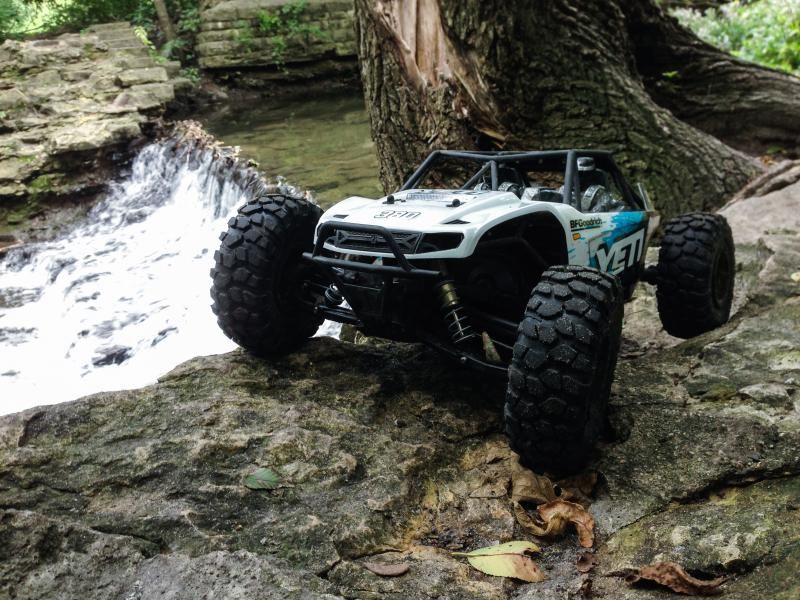

I had a really fun time crawling this thing over some rocks and various terrain today! Aside from the servo feeling weak and the castle esc thermaling a couple times, it was a flawless run! I snapped a few pics of the session with my iPhone.

I had some fun yesterday (before the stock servo gave out) driving in a creek area. Same area that is pictured in my previous post. I continue to be impressed with how awesome this thing is at getting over some pretty rough rock gardens. The stock tires may be pretty bad in the dirt, but imo, the grip the rocks pretty well. Keep in mind that this is my first crawler and cannot compare it to trepadors or the voodoos that most people seem to be running. I would like to pick up some trepadors once I get all of the durability issues worked out.
I ran into some thermal overload issues with the castle made esc while crawling on 3s. Understandable in my mind why this would happen. Little to no airflow for cooling, high current draw trying to torque over rocks and up steep hills.. Imo, this esc is way under speced for the size of this vehicle. The yeti is essentially the same size as a 1/8 buggy or 4x4 sct, yet it has 1/10 electronics. For this reason I ordered a hobbywing 120a sc8 esc. I chose the sc8 because I plan on keeping the vehicle 100% waterproof and it delivers in this area. The fan should should also help keep things cool, however I believe the sc8 should easily handle 3s crawling and bashing. I understand that a sensored system would be nice for ultimate smoothness, but to be honest, I find the stock motor plenty smooth for my needs. I am also unaware of any waterproof sensored system. My goals right now with this vehicle are as follows:
