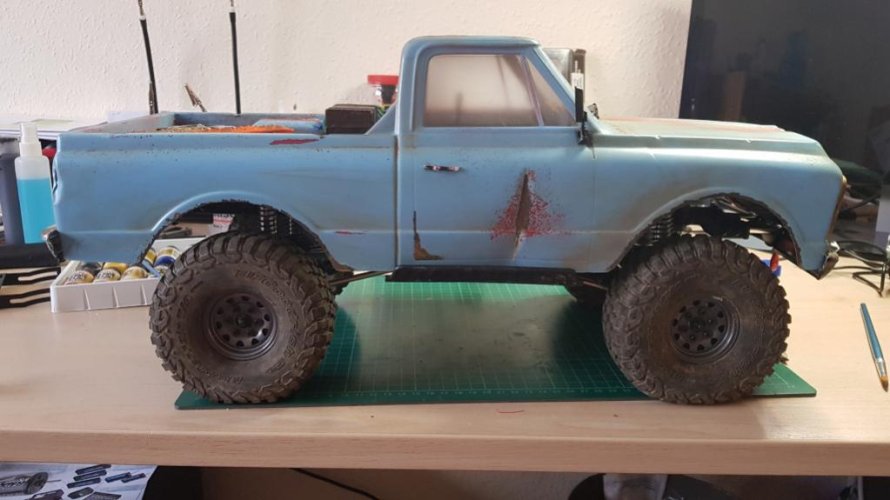

The best results in my opinion are with painting outside. I painted silver inside the shell, then a red/brown rust mix on the outside, followed by colour with salt. I used this tutorial https://www.youtube.com/watch?v=kkWskoOcVH0 and found that the salt then paint method was both effective and a lot of fun, I did use quite a lot of salt lol. I also got some ferrous paint from ebay, and using that detailed the dents and front grille after I had sealed the rest of the paint with Tamiya Flat Clear. The reason for the ferrous paint after sealing is that as the truck gets exposed to the wet it will continue to rust. For my first attempt I was pretty happy with the results.

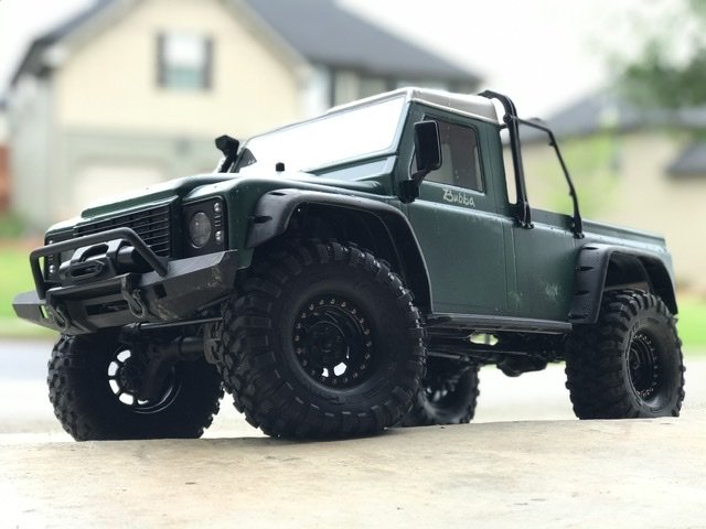

First picture the body is still incomplete but you can see the weathering. Painting the outside of the body I laid down 2 coats white to start. Then a very light “sprinkle” of hunter green. After that dried, I very slightly wet the areas I wanted to weather with water and sprinkled on table salt. It sat for about 20 min to let the excess water dry before I sprayed a final, full coverage coat of hunter green.
I wanted to make sure the faded look really came through so I scrubbed the whole thing with a green scrubbing sponge using running warm water. Last, I sprayed on a flat clear coat to seal it up and cut the sheen.
Maybe that helps?.?
