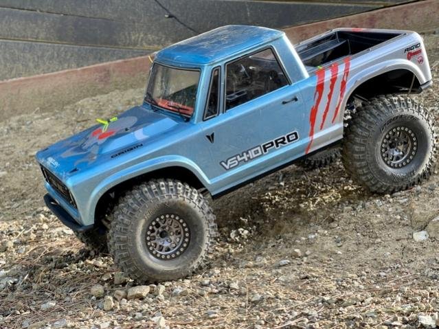

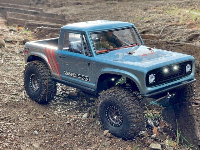

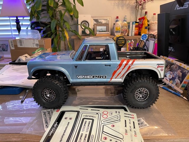

Finally moved away from the RTR Crawlers... Will never go back!
What a great father son project. Such a fun build, even for a newbie.
For those who might also be considering a VS4 for your new build, these are the parts/options we went with:
Wheels Tires Shocks:
~Pro-Line Hyrax 1.9" Rock Crawler Tires (Predator)
~Pro-Line 1.9" XL Dual Stage Rock Crawling Foam Inserts
~Pro-Line Pro-Spec Scaler Shocks (90mm-95mm)
~Injora 1.9" Wheel Rim for 1/10 RC Crawler
Electronics Motor ESC:
~Hobbywing AXE 540L R2-FOC Waterproof Sensored Brushless Combo w/2800Kv Motor
~ProTek RC 370TBL "Black Label" Waterproof High Torque Brushless Crawler Servo (High Voltage)
~Spektrum RC SR6100AT 6-Channel 2.4GHz DSMR Surface Receiver w/Telemetry
~ProTek RC 3S 90C Si-Graphene + HV LiPo Battery w/XT60 Connector (11.4V/1800mAh) For backyard fun.
~Gens Ace Adventure 3S 50C LiHV Battery Pack (11.4V/3600mAh) For the longer day trips.
Accessories:
~My Trick RC Vanquish VS4-10 Light Kit + add'l rock lights
~Powershift RC Technologies PST-250 Servo Winch
~eBay Stainless Steel Rear Compartment Panel (not shown in pictures)
~2nd Halfcab shell. One for bashing (shown). One for our vacationing and garage (in the works).
Note of 30 Days of Use:

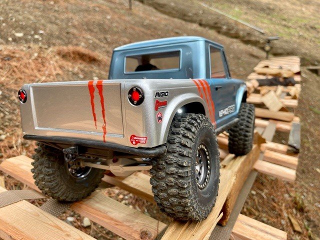

We added more lights for function. We hit the backyard occasionally at night and found the extra lights to be a welcomed addition. The only regrets I have is spending the money on a full functioning winch. Yes, its bad ass and great to show off, but really? Never used. We are EXTREMELY happy with the Pro-Line Hyrax (Predator Compound). Wow! great tire for our location and backyard setup. Also love the Axe motor. If you really want to crawl, this is the motor!

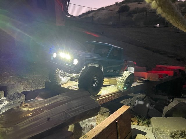

I love the light kit. Tied the brake lights to the throttle control. Headlights and rock lights triggered (rotating) via aux channel to my radio which is awesome.
Rotating Light Programs:
All lights off
Headlights (brightness level 1) and Taillights
Headlights (brightness level 2) and Taillights
Headlights + Rocklights (brightness level 3) and Taillights
Posted the brightness pics below. Super bright!

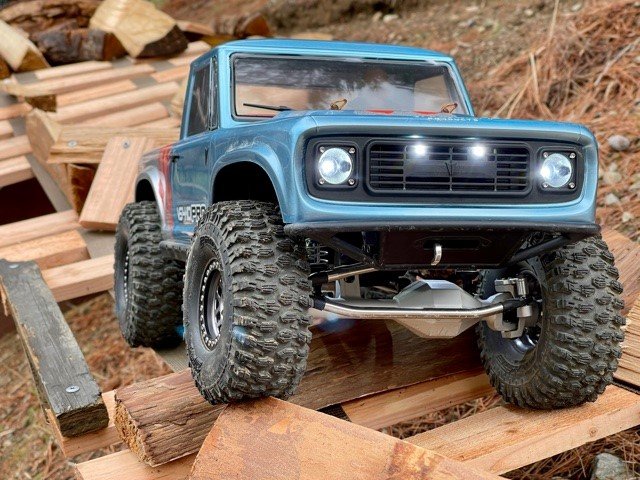

Holy cow those are bright! That is this kit that has the Dragon controller correct? Then you added extra LED's. 5mm or 3mm?
Yes, that’s the kit. Some updates/changes I made:

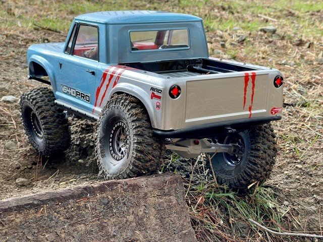

The “attack rock light pods” that come with the kit are too big and bulky to mount on the chassis (for my taste). So I removed them, and I am now trying something different with them. I stacked and zap glued them (2 pairs) behind my 2nd half cab shell. Hidden light bar. Haven’t tested them out yet, but I think they will be awesome. I’ll add a pic below.
In the above pictures though, For the rock lights, I used these instead. They are Smaller and cleaner look (from the exterior). I drilled small holes in the wheel wells And zap glued them on. https://www.mytrickrc.com/shop/traxxas-trx4-rock-lights/
Here is the picture of the stacked rock pods I’m playing with....
