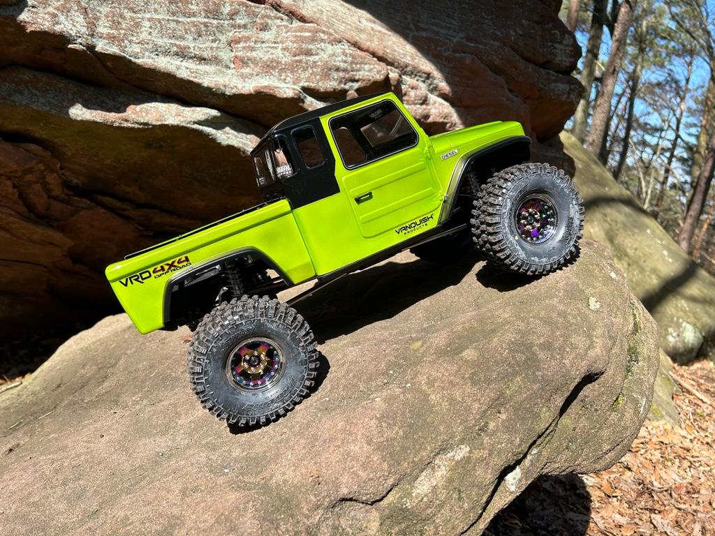

Finally got a chance to take this bad boy out..Dig seems to be working though i cant tell with the body if its fully engaged. Im absolutely impressed with its capabilities. My transmission is extremely loud though, honestly kind of annoying to both me and Hikers on the trails. Anyone else with a noisy transmission? Truck is box stock with castle mamba x and slate motor.

Check your mesh on the pinion n spur. I run a mamba x n slate 2850kv in mine n its not loud at all. But, it could be the body makin it sound loud. I ditched the body after scale nats, its just to top heavy imo. Had a cliffhanger on it, but im runnin the new PL f100 now

My portal is silent with stock body excluding motor of course, do what indybama said and check your tranny. Just remember the motor/tranny does make noise if it sounds like a whining it could just be your motor/tranny and all is good.

Body looks great! What color and brand of paint did you use?
My VFD Twin in my Phoenix isn't too loud, but does make noise. The more you drive it, the more the gears will wear in and get quieter. That is as long as it is built correctly and nothing is out of place inside the transmission.

Took the tranny out and gave it a once over, so far looks correct. I’m running the same esc/motor combo as indybama. I’ll keep driving it and see if it gets any better.
Thanks! I ended using Createx wicked colors pearl lime backed with silver then black. Everything seems right, ended up giving the pinion/ spur a bit more space, hopefully that will tame it down a notch. I’ll give it some more mileage and see if it quiets a bit.
