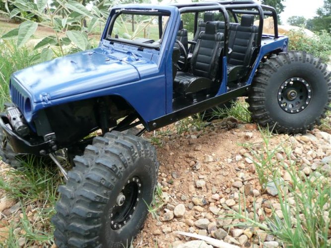

I used that stuff on my JK build. It holds up good but it stinks! The smell is going away but it's still there. I had a few people say, what's that smell? when they picked it up.
Freshly painted poser shot.
