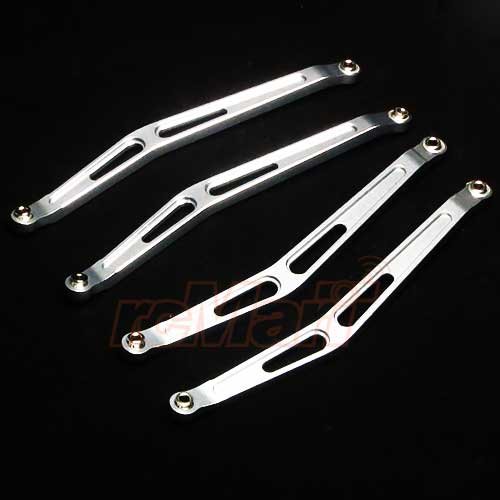

Upper and lower links. Not sure if the steering links I had were Treal or not, I'd never seen them before (I picked up my Wraith used). The Vanquish links were pricey, but man, this thing is solid as a rock now, worth every penny 8)
You will eventually have problems with any link like those in the pic, either steering tie rod or drag link, or any suspension link, that has those captured ball ends with the brass retainer rings.
Treal, Integy, Boom, GPM, HR, they'll all do it in the end
That goes for any shock using them also.
The retainers eventually wear loose in the aluminium link & the pivot balls develop bad slop in the linkages.
Any solid rod link, stainless or titanium as preference, with M4 thread on ends, most often using Traxxas Revo ends, is far superior in the long run.

As posted above Vanquish / Incision
SSD & Samix do some also
https://www.amainhobbies.com/search?s=Wraith+links
I have several variants for the RC4x4 Stainless links too & never had an issue with any
https://www.facebook.com/pg/rc4x4performancestainless/posts/?ref=page_internal
Avoid anything that has only M3 ends to suit stock Axial rod ends, they're well known to be not as durable as the M4.
