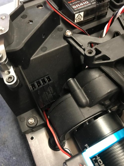

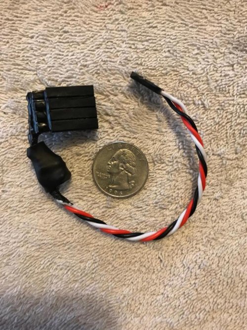

The lighting controller from Al at HeyOK showed up today and I promptly got to work installing it. (Spektrum DX4C Tx). After figuring out a couple bugaboos with my set-up, the controller works perfectly and is quite small / easily hidden with the capability of having 4 different lights. As far as the issues, the DX4C has the AVC function. You HAVE to INHIBIT AVC in order to get the Aux ports to be recognized at the Tx and be assigned to your desired button for operation. I went with the E button - 2 position. Pics below. 1st pic shows how/where I'm going to mount it. 2nd pic is for size reference. "thumbsup"
