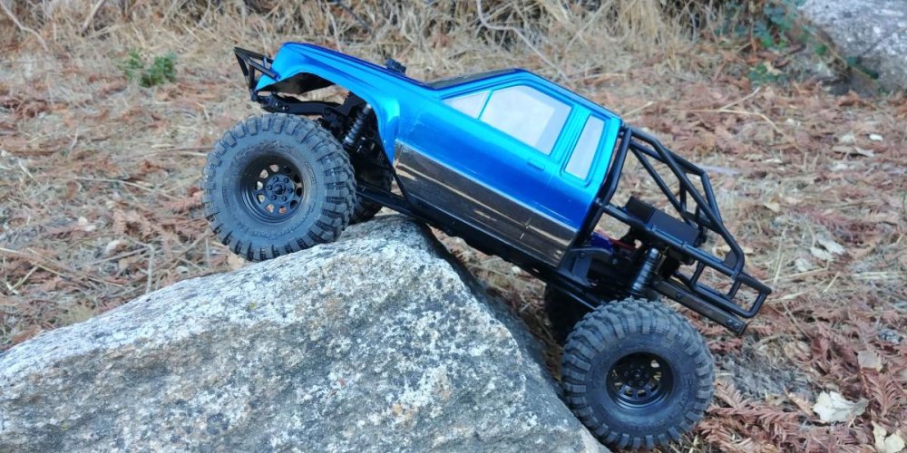

HH Puller Pro 1800kv brushless.
It is running on 4S with 14t pinion/45t spur. Will go faster than I can run, but with tons of low speed crawl control.
Stock sport kit gearing of 17/39 not the best for crawling, too fast.
I found a tiny 2200MAh 4S lipo from Hobby King, running 2+ hours so far with not much loss of juice.
