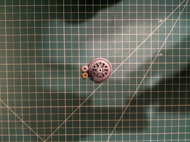

You would know it if the pitch of the pinion and the spur gear were different. The stock Traxxas gears are 32P. The other common pitch is 48P.
Here's a picture for comparison. The top pinion is 32P and has teeth the same size as the spur, the bottom is 48P and has much smaller teeth.
