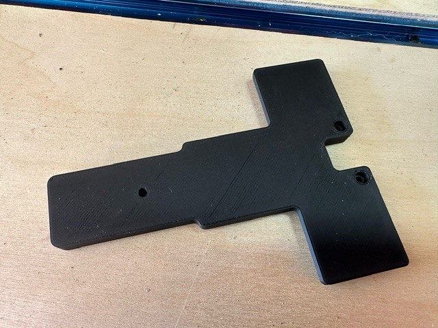

I have done some mods. Not being a fan of Traxxas' RXs, that was the first thing that needed to go. Of course, that meant the ESC had to go as well, they are kind of connected...
My first step was to design and print a t-style e-tray. I used the slot on the cross member of the back shock tower as a mount point, using a 3mm screw.
image0 (5) by Scott O, on Flickr
image1 (4) by Scott O, on Flickr
The HW1060 went on one side, and the Sketrum RX on the other side.
