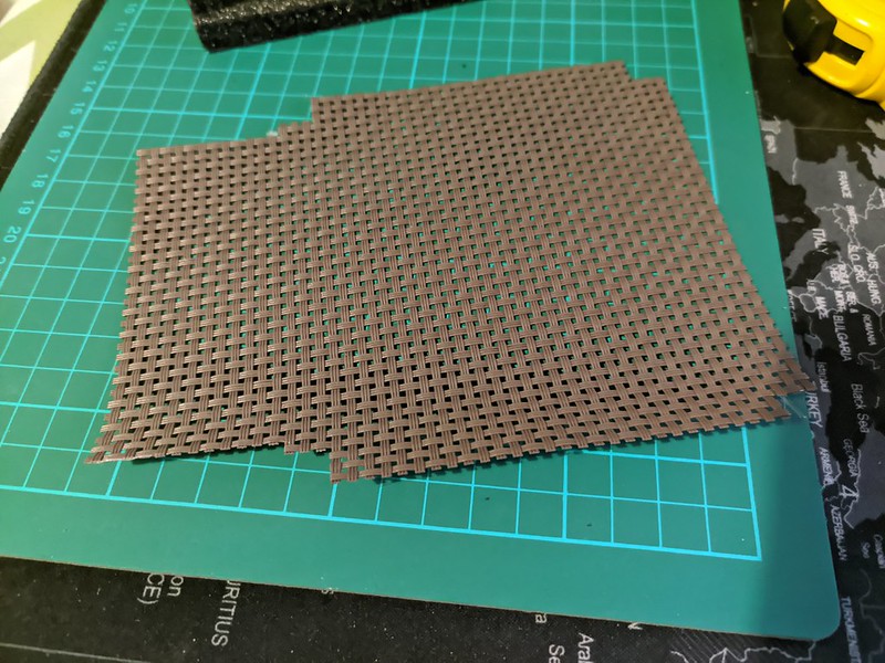

About time to close that big hole on the floor, I had to cut for the inner fenders and the mounting system.
I wanted something as lightweight as possible for the job. Found this piece of foam that I cut in 2 pieces and will glue together to make a L shaped structure.
I thought about using some kind of cloth to cover it, but this dish mat will last longer.
I used double sided tape to mount it on the car.
Used E6000 glue to keep the dish mat on the foam and some toothpicks to hold it in place will the glue cured.
Here is the finished construction.
Mounted on the car's floor. Looks better than the hole that was there before and it will keep dust and water out. Most of it anyway.
