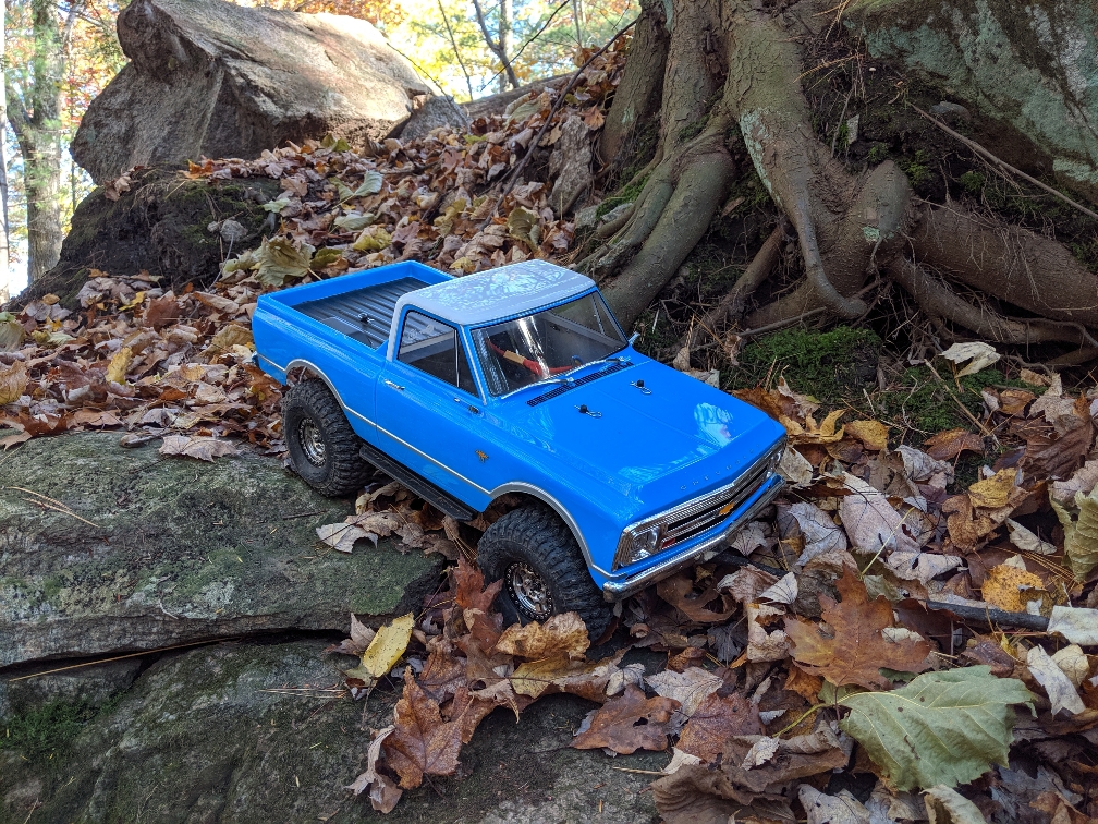

The Axial 1967 Chevy C10 body fits really well. Just need to swap the rear body mounts for the ones that come with the sport. No trimming required.
