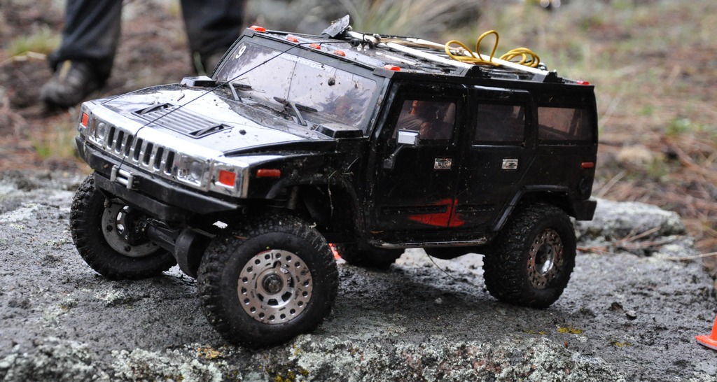

1st Place - Locked Up driving The Trail Ready H2
SCX10 Chassis
Tekin FXR
Castle Creations BEC @7.2v
Futaba 4PK-S
Hitec 7950TH servo
Zippy 2200 3s Lipos
3 racing winch with Heyok Controller
Electronics waterproofed in a Rat Shack Box
Custom LEDs
Brood 45t Motor
87t spur & 13t pinion
Aluminum transmission gears
Axial Under/Over Gears
Bonus Line chromoly rear locker
Super 300s up front
Modified Gunnar Tubes
Axial aluminum c's & knuckles
Axial straight axle adapters
Axial straight axle shafts
MIP driveshafts
New Bright H2 Body
Full SUV interior with 3 row cage
Hand Brothers front 3 link (modified)
Custom servo plate
SCX10 shocks
Motoworx Beadlocks
RC4WD Mud Thrashers

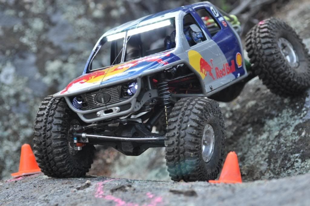

4th Place - Diffuser driving the Red Bull truggy
Axial based frameset
Tubework by Difuser(me)
Castle Mamba Max
3s Br00d Lipo 1350
Br00d 30T Garret special
MSD wheels no weight
Crawler Innovations 2-stage 1.9 foams
Servo Winch DS821
Chino Laser light bar
KC Jones Led Kit
Tamiya Tundra
Red Bull graphics from Krawler Koncepts
RC4WD Irok's
Front:
Hand Bro's CMS
KC Jones Beef Toobs
Axial OD
Axial CVD's
STRC Knuckles and C's
Axial kit shocks HPI main springs Axial helper
Rear:
Axial UD
STRC Lockouts
Axial kit shocks Vendetta main springs Axial helper

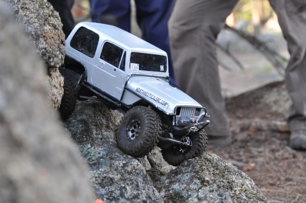

5th Place - Nate08 driving his Jeep
SPECS:
SCX10 Frame Set
Hand Bros CMS
Tube work and Metal Bumpers by me
MIP CVDS and Vanquish High Steer Knuckles up front
Axial UD gears in the rear axle
Full Robinson Racing gearset in transmission
MIP front Driveline, Stock Axial w/collars rear
Integy AX10 shocks with HomeDepot droop springs on all 4 corners
Stock SCX beadlocks with original Rokloxs, stock foams
HH esc
HH 7t puller
645mg steering and winch servos
2200mah 25c 2s lipo from CBP
vinyl lettering by Cherokee Pat on NWSRC
license plate by rokpile

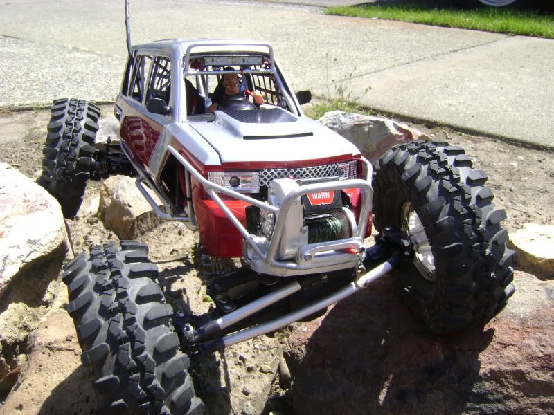

4th Place - Hotwheels000 driving "The Rectangle"
Specs:
Team3six bucket seats and a custom bench seat for the rear
Axial scx chassis
MSD winch
Hayok winch control
SDS "stacked" transfer case
Tekin T-8 1350 kv
CC MMP
SDS super 300's
Hand bros 3 link
Axial over/under drive gears
Cheapbatterypacks.com 6s elite packs
Vanquish SSZ wheels
Vanquish c hubs for scx axles (if avail in time)
GCM steel axles for scx
Proline swampers
Blah,blah,blah
