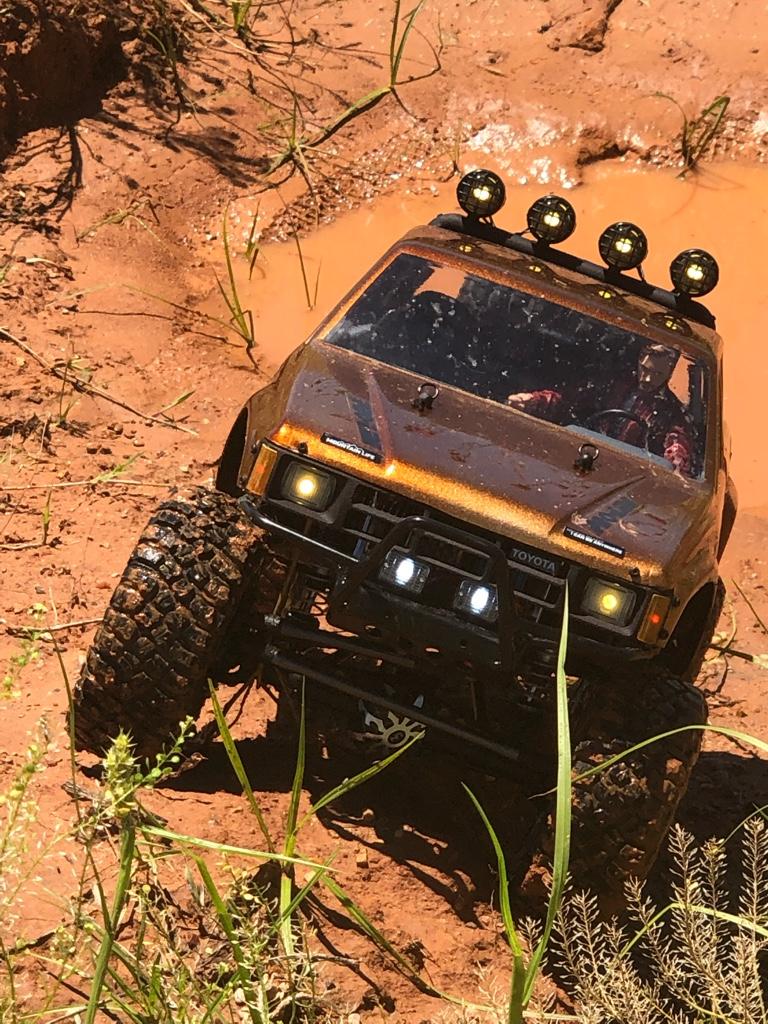

I’m really impressed with the proline km3 and proline foams on my trail trucks. I run them on a brushless G8 with a heavy interior and a heavy scx10 ii with lots of metal, a spare tire and interior. One thing that I’m impressed with is the give of the tire and foam on a bad landing. I feel something about the combination allows bad landings over bumps without flipping. My Ottsix flip easily.
In sum, I’m saying that a 2 stage foam with the right shape tire seems to be my ticket for a trail truck. Plus they are scale and look awesome if you use a paint pen to fill in the lettering. They also don’t clog with mud in my area which I can’t explain given the somewhat tight tread pattern.
Don’t judge the weathering. This is an in process look. No interior either. The paint has stayed on the tires though.
