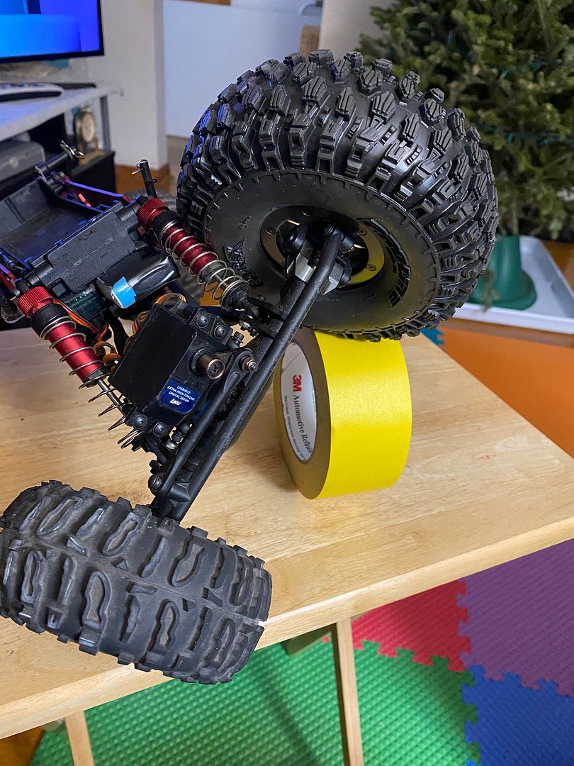

Ok, I ordered a set of Hyrax 2.2’s and 2 Stage crawler foams for my Losi Comp and Night Crawler and they’re freaking huge compared to the Comp Claws I put on the LCC a decade+ ago and original Rock Claws for the LNC. Problem I have have is that the tires are grabbing the shocks and springs on both rigs. I can flip the upper shock loops so they’re closer to the chassis, but still have clearance issues. The trucks still have their stock 6mm thick aluminum and plastic hexes and the factory rims on the LCC are starting to crack where the beadlock plates thread into (haven’t checked the LNC’s wheels yet) but still take the screws for now, but both have the aluminum 20 degree castors.
Think I can get away with a set of 8mm thick brass hexes for now or should I start looking for new wheels with a deeper offset instead?
Here’s the hexes I was looking at or something similar.
https://www.amainhobbies.com/samix-...x-adapter-4-8mm-offset-samscx2-4063-8/p871726
Thanks
Looks like tire rub wasn’t the issue I expected it to be, but nay still look at least for the brass hexes and new wheels are going to be mandatory at some point.

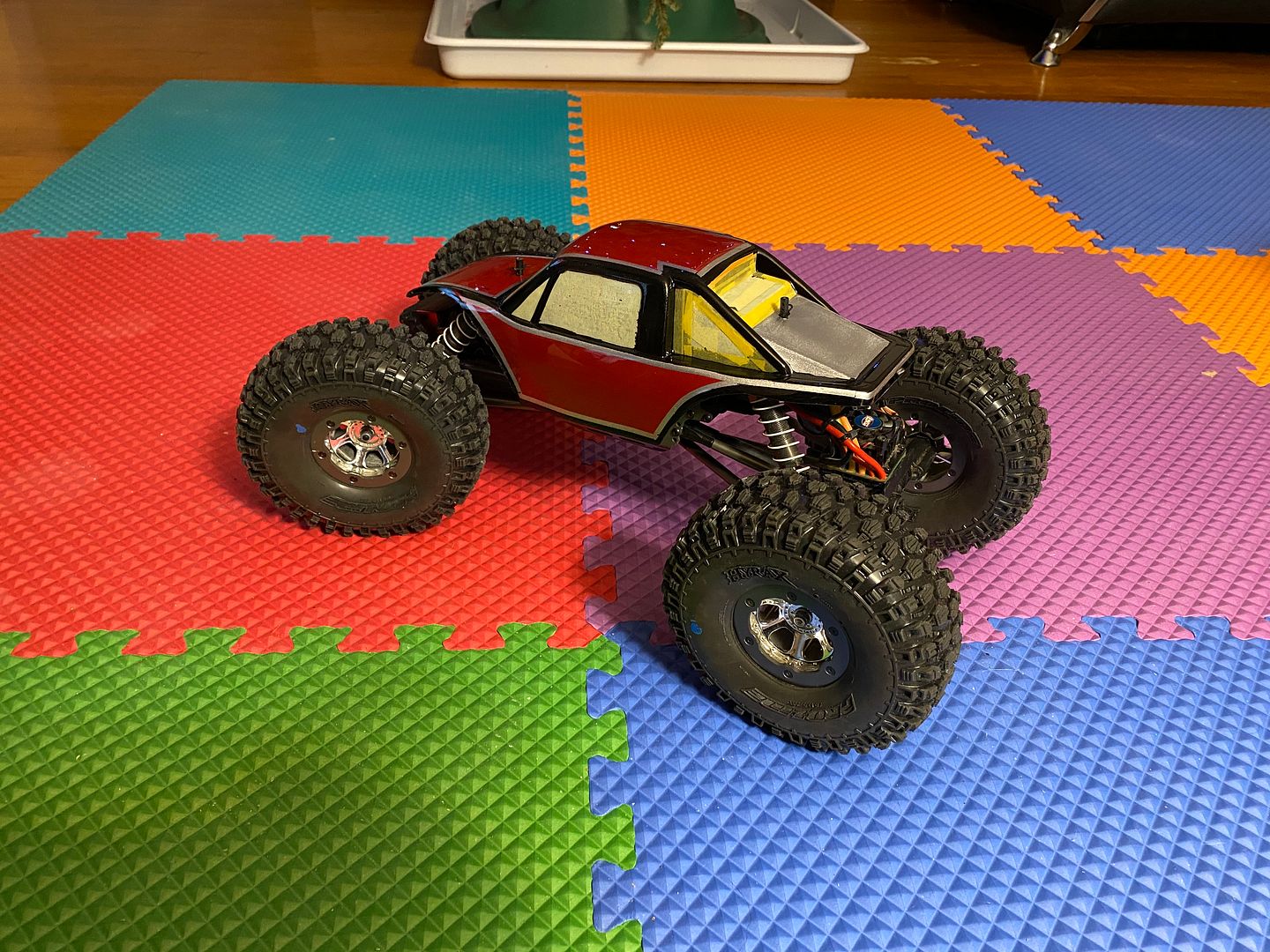

Looks like I may need to trim The body a bit up front before I finish painting it too, this looks ridiculous with these huge tires on it:ror:
