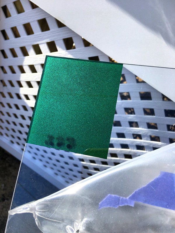

Ran a paint test..looking to get a color close to that of the new Mustang Bullitt and I'll add some graphics halfway down the body to break things up a bit. 2 Coats PS-17, 3 coats PS-22, 3 coats PS-5. My first time ever painting lexan but I think it turned out close to what I want. Will probably do a few more tests...
