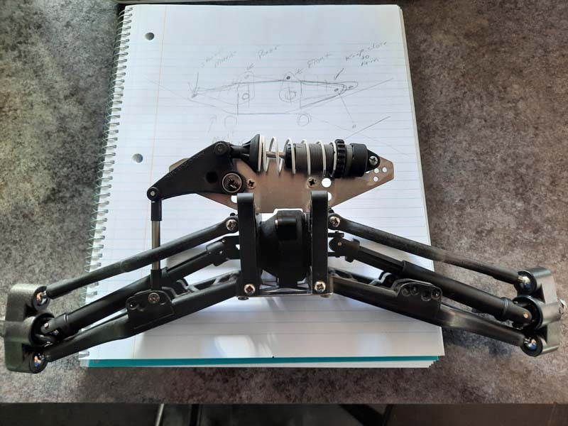

Sometimes cool ideas happen to pop up out of nowhere. While helping my daughter with her math homework (and trying to dredge up stuff I haven't thought of in 35 years) I was idly thinking about what to do with those tall shock towers. Having just built up the Summit project, I got the bright idea of somehow adopting the rockers over to the Maxx platform. So in between trying to explain how to re-write equivalent expressions to a reticent 11 year old, I was doodling on my notebook and came up with a plan. The next morning before work, I ran down to cut up a piece of scrap aluminum and drilled some quick holes, stole the front end off the aforementioned basher E-Maxx, and played with some leftover project parts. Boom! Turns out it's not hard at all.

So of course I had to go out and burn a paycheck and ordered a ton of bits and pieces. Actually, there are a ton of TRX chopshops still on e-bay and I found everything fairly cheap. I needed front LT rockers all around since they had a bit more offset, so I ordered two sets of those, plus posts, shocks and pushrods. I found these HB 4x40mm turnbuckles for a whopping $2.36/pair, and used some TRX4 rod ends.
