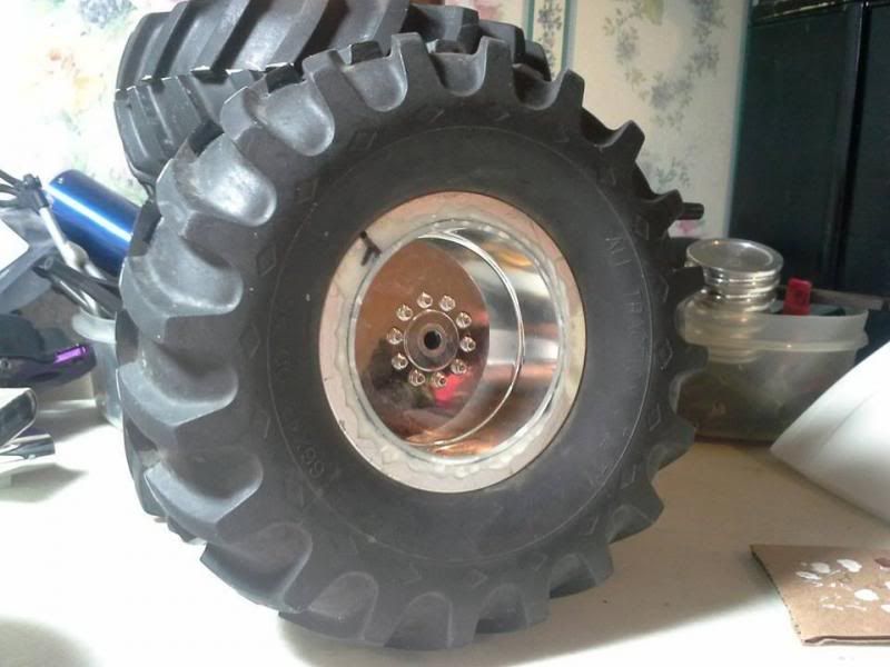

Next up is to get the tires, of which Robbie Billings finished last night. Here is a shot he sent me -
When I get them I'm going to drill them into my CPE Wraith to Clod adapters for extra support given all the power. I'm then gonna scuff the wheels up and paint them flat black. They are right at 2 inches wide and about 6.25'' high.
