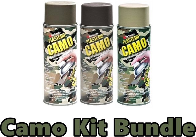

Plasti dip Camo to lexan
3years now, no issues at al, one can , simple. handle flex , strong, great true military
matte color
I have to 2nd Jjay. I've used it and it's durable and won't flake.
