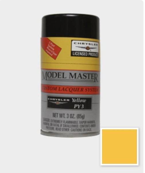

You can also do this
Testors Modelmaster Chrysler yellow, very similiar to Land rover

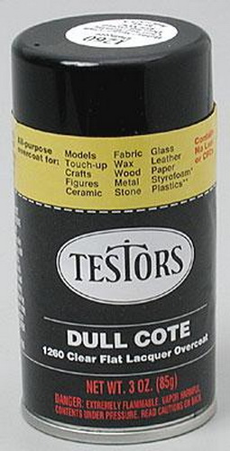

and flat clear coat

or tamiya TS semi gloss ts79
I'm a firm believer in shooting a final coat of Tamiya PS-55 Flat Clear over the exterior of any crawler that I'm really trying to make look scale.
Glossy polycarbonate (Lexan) makes everything look toy-like, because it has the effect of making your R/C look like it has shiny clearcoat as thick as the body is.
Sometimes I don't do it on bashers, because they will quickly get scuffed and scratched and that takes care of that problem!
I did my silver TRX-4 Defender after also shooting the roof white, and my yellow Ascender Chevy K-10 after shooting the hood in black.
The layer of flat clear also is pretty durable, so your vehicles stay good-looking for longer.
Find a good yellow to shoot the underside of the Lexan, maybe back it with either black or silver to darken it a bit - and then shoot the clear on the outside for best results.
