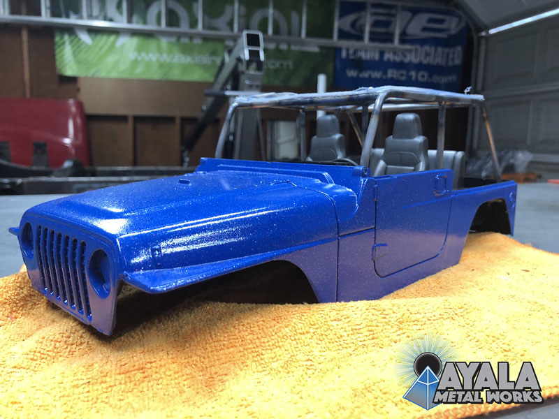

Time to pick this build back up, Jamie asked me to build some bumpers,sliders and a roll cage for his sweet LJ. I finished the metal work a few months ago and just getting around to posting it. (picture heavy) I started by getting the frame welded and then made the front bumper. All tubework for this build is 3/16 DOM steel Tig welded.
Bolt on Front bumper
Starting rock sliders
Moving along with the build
Had to take it to the rocks to see how it looks!
#Texas
I welded the rear bumper to the frame cause their was no cross bracing in the rear of the frame cause of the cantilever suspension. So now the rear bumper is the frame cross support.
Time for the fun part the roll cage.
I glued these 1/8'' Aluminum plates to the bottom of the body. The cage bolts to the body with 4 bolts threaded into the tube.
Time for a Roof panel
Now that the tubework is all done, I got the frame and all the tubework painted in black Steele it. Also got the Delrin sliders made.
Final assemble
Roof panel or not I love the way this LJ came out! Jamie did a great job making the body and painting it! I'm excited to see Jamie Finish this build and paint the roof panel. But of course im most excited to see this on the trail soon!
