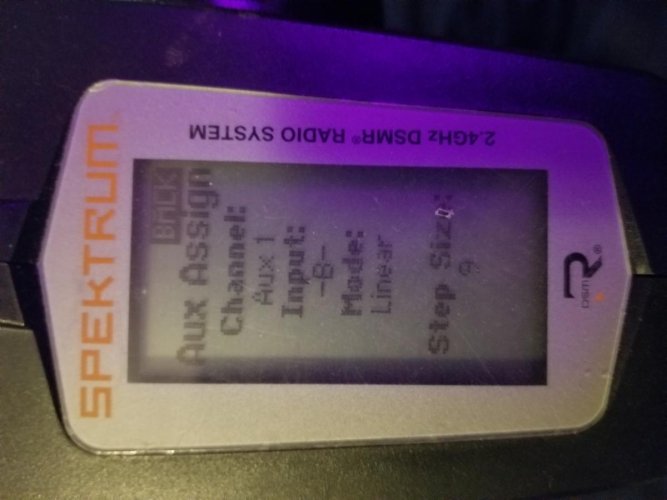

Pretty sure these 3 screens are all I messed with for the rear dig and dual esc setup.

you click on the selected item in screen shot 1 to get to screen shot 2. I named it dig myself, some how.
Screen shot 2 is how to set up the moa and dig.
Screen shot 3 is how I adjust the rear to change speed compared to the front, usually I have it set to zero, and adjust as needed, then back to zero.
screenshot is not ideal, as over adjusting it causes the rear to engage, but for the price, I am happy.

This is done by disabling the mix, this is accomplished in screen 2, the mix I called Dig
