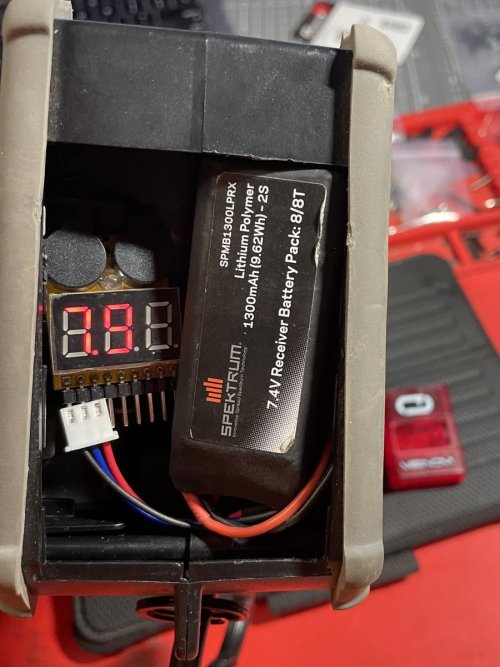

Just in case anyone is tired of buying AA's.
I cut the battery tray out and soldered in a JST plug a while back, so I could use Spektrum 1300mAh 5c receiver batteries. The transmitter doesn't turn off until it gets below 6v, which is problematic. After accidentally over-discharging a battery the second time, I bought the cheapest low voltage alarm on amain. With the plastic case popped off they both fit nicely. I just looked on amazon, and they have the same thing with heat shrink for $5, so I'd go that route. The alarm is stupid loud, too.
I run those same alarms in my vehicles which don't have LVCs. And yes, they'll wake you up if your batteries hit LVC overnight while the alarm is plugged in.

You can change the low voltage cutoff on the dx5c and the dx5pro. I don't have a rugged.

I didn't see an actual cutoff in the settings, but the highest I could set the alarm to is 6.0v... which is still too low.

I've never timed it... All day for sure. I always take an extra with me and I've never had to swap one out. Also never over-discharged one in a single day's use (5-6 hours usually). I'll guess that they last 8-10 hours.
I crawled for about 4.5 hours today. My battery checker says the spektrum 1300mah battery is at 46%. I'd say it's good for 8 hours max. That's plenty for me, though.
I modded my Rugged for a LiFe pack about 5 minutes after it was released. These Hobbyking packs are the same ones I use in a my Futaba and Radiolink radios so it was nice to not need a different size pack and the LiFe batteries don’t need an external alarm.
I've been running a 2S on my DX5C for two years with no issues, other than I'm not buying AA's all the time!
