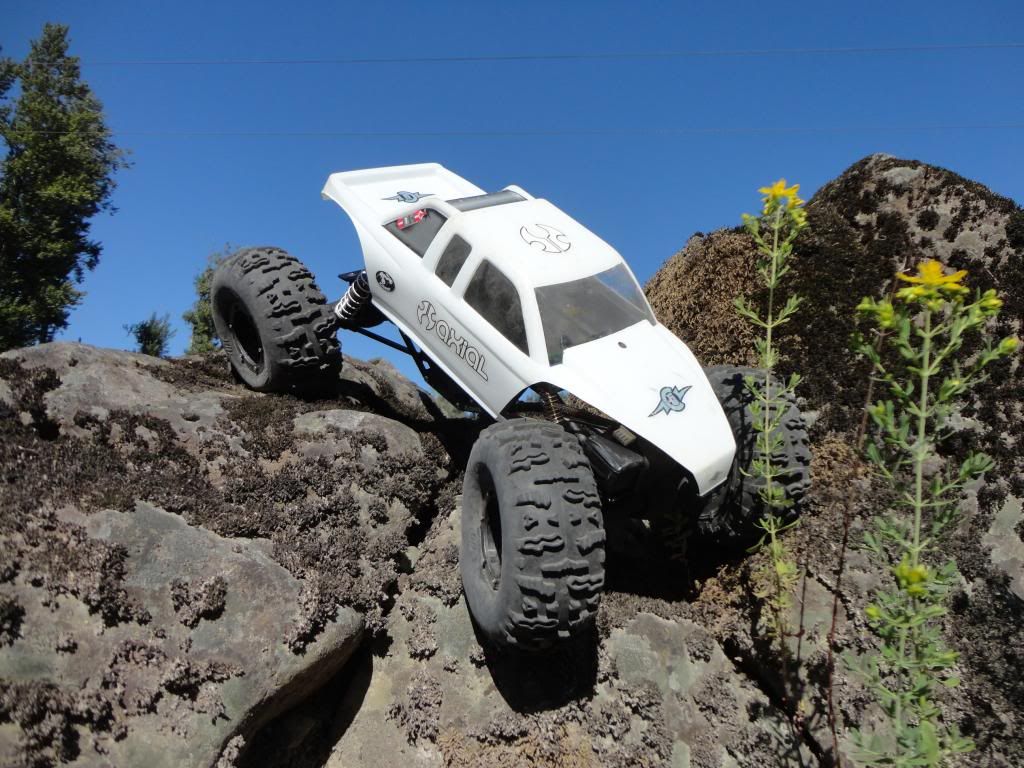

I took her out this morn for a bit of torture on my rocks.
I went from a square last year (12 1/2" WB with 12" track width) to 12 1/2" WB with 10" & what a difference.
Hopefully sunny weekend to break her in a bit.
I swapped the Mamba out for the ol' FXR till I can get to a castle link & hopefully smooth it out a bit.
Really happy with the Traxxas slipper. It works as a slipper should, I don't notice it till I get bound up then it slips & saves me buying parts.
