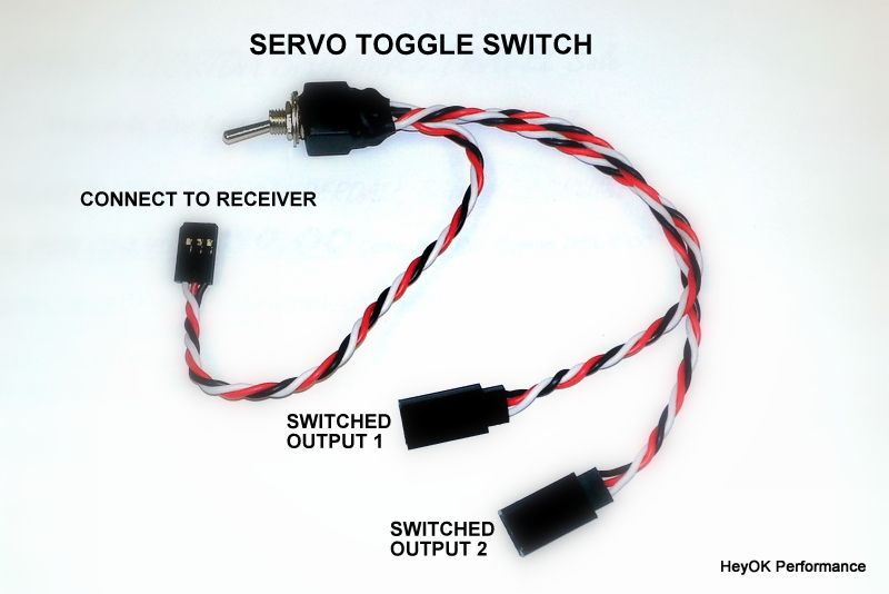

Have more servos than you do channels? Want to run a remote light switch and a winch but can only plug in one or the other?
Maybe you need a Servo Toggle Switch 8)
Made using 22 gauge servo wire and a switch with 5 amp contacts!
Plug it into a channel on your receiver and then connect the two items that you want to operate into the two switched outputs. Move the toggle switch to send the power and servo signal to either output.
Part Number: SVTG
$15
Upgrade the Servo Toggle Switch to the Water Proof version for $4 more.
You get a rubber boot over the toggle handle and the soldered connections are sealed with Plasti Dip.

So with this, is the only thing 'switching' the receiver signal or the power output as well?
For example if I hook up my LEDs and a winch. If I toggle the switch to go from LEDs to the winch, will my LEDs then turn off? or will they stay on?

This switch actually switches both power and servo signal. If you were to use it like you described, you would see the LEDs turn off.
Are your LEDs connected through some kind of RC switch? If they are not switched, you could just use a Y cable to get power to both your LEDs and your winch. The LEDs would be on as long as your receiver is powered up.
Oh my LEDs are connected to the receiver so they are fine. I was just curious about the operation, and after re-reading the initial description you do mention power AND signal are swtiched so thats just my mistake for missing that =)
Do I need a second winch control if I plan on running two winches off the servo toggle?
If you use that particular switch, then yes, you would need a second winch controller.
But, it you just got a switch, you could use one winch controller and switch its output to feed one winch or the other.
Send me a PM if you are interested and we can figure out what you would need exactly.

I think I would take a slightly different approach.
Leave your winch plugged into one channel and use this light controller in the other channel:
http://www.rccrawler.com/forum/vend...-dual-rc-switch-led-lighting.html#post3014403
That light controller needs a three position channel. Flip that channel to the left and back to center to toggle light number one. Flip that channel to the right and back to center to toggle light number two. That's an awkward way of saying that you could have one or the other or both lights on or off.
Or, use this one:
http://www.rccrawler.com/forum/vend...rk-lights-head-lights-switch.html#post3805084
Which gives you:
Off
Light 1
Light 1 + 2
Maybe you would be set up like this:
CH1 - steering
CH2 - throttle
CH3 - Winch
CH4 - Dual RC Switch

I can make the lighting controller switch battery power instead of receiver power.
Just add the letters EXT to the part number.
RCSW2EXT for the first one I described.
PKHLEXT for the other.

Can I still buy this? I just recieved my heyok 3 position winch controller that I plan on running my rc4wd warn winch and want to run a servo winch in the rear.
Yes, this part is still available.
It sounds like you want to run two winch controllers. I have another idea that might save you some money.
You can think of the switch as having one input and two outputs. If you run the output of the winch controller to the input of a switch, you can then run the two to your two winches. This way you only need to use one winch controller.
Send me a PM if you want to do this and I will get you set up.
