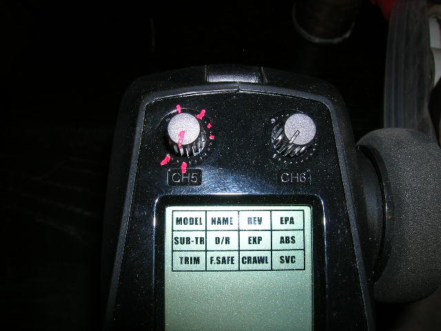

Try putting your Dig on a Potentiometer. That way your servo doesnt Slam the Tranny in and out of Dig at Warp speed. Ive found that its a lot easier on the Servo, on the plastics, on the Transmission, and it works Great on my SCX10iii JL. You still need to set end points, but the slow speed at which the servo moves when actuated by the Pot, makes the whole sequence nice and smooth.

I have a GT5 and could totally run it off of a pot. I may do that and see how I Iike it.

I have mine on ch6 on the gt5. Tryed it on ch3, so it was 4wd or dig, but i couldnt get it dialed in right n screwed myself on c3 course 2 at scale nats. Went back to the pot n it works great
