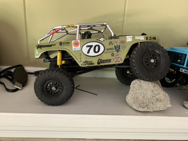

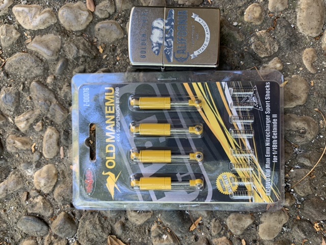

I also run droop and swear by it. With this little rig though, I run no internal springs (I don’t feel it needs it) with old man emu scale shocks. I’m thinking about trying putting springs in it though and just cutting down the stock springs that came with them… I don’t know? I kinda like it without.
And please send me your complete instructions on how to three link with chassis mount of the servo to this baby! Or just all the parts if you have them lying around…"thumbsup":)"thumbsup""thumbsup" I think that’s the best mod I’ve seen so far!!
