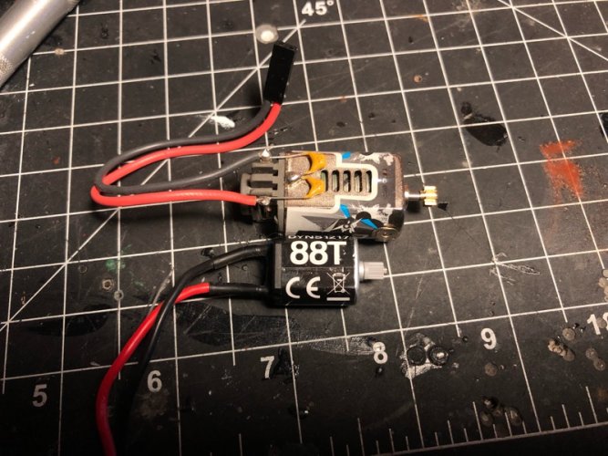

In my experience with building micro’s you just need a bigger motor. The small brushed motors do fail, but with a 130 or 180 can brushed motor you get plenty of power and torque without over working the motor. I have brushed motors that are still going strong after 10 years, however I’ve never been able to get a brushless motor to last longer than a couple of batteries. With a 180 can motor I’ve never had any issues.
On top of all that, a quality 130/180 motor can be rebuilt if it does fail which is rarely.
