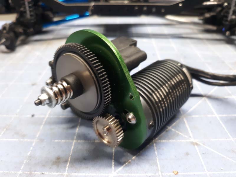

Found this big old 2400kv 550 in my stash, and bolted it up to a 2-speed Vaterra trans left over from my Twin Hammers. Gearing is going to be a issue, This truck is NOT geared for speed, and the additional reduction in the Axial axles compared to the Vaterra axles doesn't help. I'm starting with the largest pinion I can stuff in there just to get rolling but I'm sure I'll need to change this later.
Modded the Wild Boars to work with the Vaterra trans. I had to shave them down a bit so the setscrews would sit on the flats of the trans outputs. I hate setscrews...c'mon Vaterra, it's not 2007.
