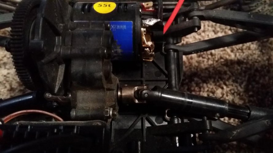

I run 2 of those Holmes extended outputs in AX10/SCX10 housings. One I faced the longer output forward so I could clear a Traxxas Maxx shaft on the spur. The other I run to the rear to clear the Wraith skid. It's strong and versatile.
